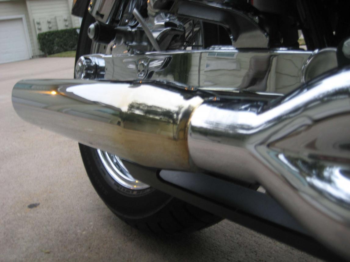

I recently put a python 2-1 pipes on my 09 FXDC.
Rode for less than 500miles with Stage I on my bike.
Everything was wonderful with the pipe looking great in chrome.
Did a cam change gave to a HD dealer in Houston for a dyno tune. Mancusso Harley to be precise in North Loop FWY..
Today I went to pick up my bike and I was in a state of shock looking at the way my pipe color is disfigured.
I asked the dealer and he said, sometime this color disfiguration happens..
It really hurts to see my new pipes in this color
Is there something that I can do to the pipes to bring it back to its original chrome shine or do I have to live with this S**T.
Who should be blamed for this guys?
Should I ask the dealer for compensation
Attached Thumbnails Python 2-1 color disfiguration-a.jpg   Python 2-1 color disfiguration-b.jpg   Python 2-1 color disfiguration-c.jpg   Python 2-1 color disfiguration-d.jpg

Try some "Blue Away" now that it's tuned it shouldn't do it again. Where's that Dyno sheet?

I have the same pipes.The clap is loose on yours and lets sum gas and heat get out.Thats what turned them blue.I used Mothers mag & aluminum polish, brasso and #00 Very Fine Steel Wool Pads to clean mine up.

I would say mothers aluminum polish will clean that right up. and yes it is quite possible the flange is leaking there as well. 2-1 pipes can be a bear to get lined up perfectly and leak free. I doubt the tech took the time to line everything up perfectly on the pipes. I just had my shields and exhaust powdercoated. I think I must have had mine installed poorly myself before cause now I really made sure everything was right on and the pipe is much louder, deeper and I have no pinging after a ride anymore. I think I might have had a slight leak at the front or rear flange before. Not to mention my canister is now sitting about 1/4" higher on the rear bracket mount(real important cause I kept scraping the rear of it in corners).

the bottom of my rear pipe turned blue from the front pipe exhausting on it i used blue away didnt have to rub that hard it came rite off and didnt leave any scuff marks try it on the bottom of the muffler first
