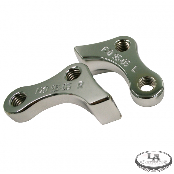

Ok, so no one seems to comprehend what I am explaining here, I will do the best I can with pictures of the blocks. First, the over priced name brand kit (ness) is obviously not the same kit as the other brands (which are probably all the same).
Picture 1: Arlen Ness kit
The center hold bolts the swing arm at the original shock mount. The end hole becomes the new shock mount to the rear of the swing arm, changing the angle, lowering the bike. Simple.
If you take notice, there is a portion of the block that will be infront of the swing arm shock mount. This makes it so that the block can not in any way pivot or move, for example when the bike is jacked up.
Picture 2: Off brand kit
To me it looks like the writing goes to towards the tire. That means the hole at the end bolts to the swing arm at the OE shock mount and the hole in the middle being where the shock mounts to. (that was how the Honda kit was) With this design when you jack the bike up (no matter how tight you make those bolts...) the block will pivot and almost create an extension to the shock. In my mind this creates the (unlikely) possibility that this could become a moving part if something were to happen. It is not rigidly mounted to the bike.
I was just trying to get a couple pictures to confirm both my memory of how the ness kit mounts and how I think the other brands mount.
