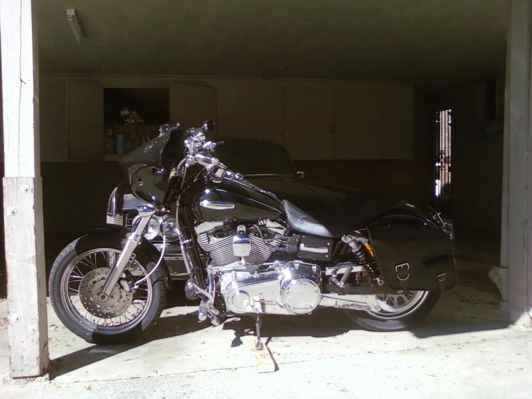

That four tire hotness is a diamond in the rough, aka serious lump of coal, '65 Lincoln Continental Sedan.
