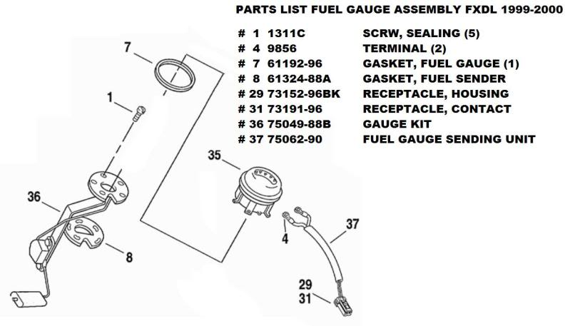

Originally Posted by Good_Apollo
Not really sure what the major difference is in the fuel sending units for the 2000 parts list and the 2001 and newer, but the part numbers are different. I assume if you match up the fuel gauge from the same year(s) all should work fine since the tank is the same from 96-03. Wonder if the wiring is different.
Check out these images for the differences....You could be right on the fitment although I'm not sure...
