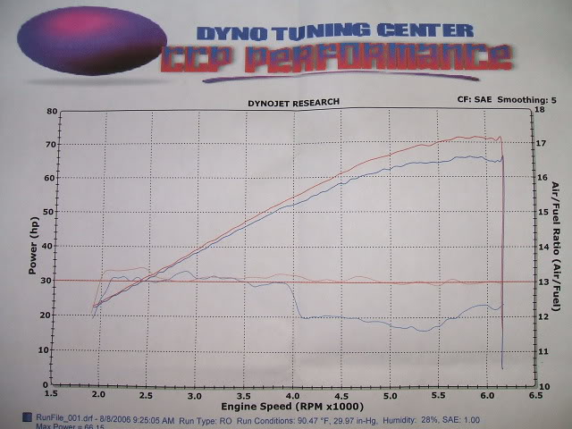

Had my dyno tune done a coupla weeks ago but his printer was down and I just had time today and go back and get the print out.
power and torque

power and a/f ratio
Bike runs better and gas mileage is better.
Blue is fuel moto map,red is after tune.
Good Luck
Tom

Not much really. SE intake with the round nostalgic filter cover, SEII pipes,stage I down load then I added the PCIII. Bike ran good before the tune but the gas mileage fell way off after I added the PCIII. As you can see the map was really rich in the upper rpms before the tune and I tend to wring it out pretty good. Gas mileage is back up now and still plenty of power.

There is a noticeable difference. Before,even with the 25 degree injectors and the stage I, off idle was jerky and some surge,a little flat on full throttle accelleration. After the PCIII,smooth as silk,noticeably better acceleration in the power band but running rich,gas mileage dropped. After the tune,which leaned it up a bit,still have all the power and acceleration and better gas mileage. Well worth the 250 I spent for the tune.
