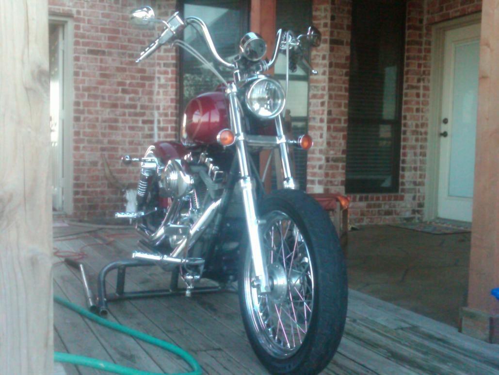

I don't have a bike lift perse but I fabricated a "stand" out of 1.5" tubing. It either lifts the front or the rear wheel 10" of the ground, plenty of height for me to do what I need to do. I can easily raise OR lower the bike without help. Total cost $30 in material. I made an autocad drawing, let me know if anybody wants a copy (you will need AutoCad or AutoCad Light 2009 to open the file) or I can take pics and give you dimensions.
