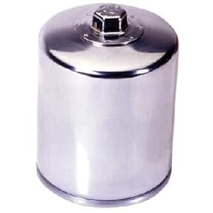

Try these from K & N...they come in various sizes, both in black or chrome, and can be tightened and loosened with a socket wrench.
Below taken from an Amazon ad:
K&N 171C 4 Pack Chrome Oil Filters Harley Davidson

I use those filters but I'm not sure that's the problem. When installing the oil cooler adaptor, it's easy to over or under-tighten it.
It could also be one of the lines from the cooler to the adaptor.
If there's no oil cooler on it, then it's time to start considering other problems. Maybe the MoCo got hold of a bad run of filters. Maybe they're under/over-tightening the filter. Maybe the housing where the filter seats is screwed up. Maybe some nasty got on the filter housing seat and that needs to be looked at.
That hex nut on the end of the K&N filter is for ease of use, not for putting 20 foot-lbs on the filter.
I had a mechanic put a filter on too tight one time and I had to rip the body of the filter apart and take a punch to the filter where it connects to the housing when I went to change it at the next oil change interval. No fun. And it was a total beyatch to get off even then. NEVER over-tighten an oil filter. Bad things can (and usually will) happen.
