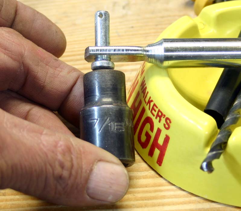

I cant get the pin out that holds the rod on the break pedal. I hit it with some wd40 but no love. Any tips?
Any tips?
simple operation.
get your clevis pin press out.
