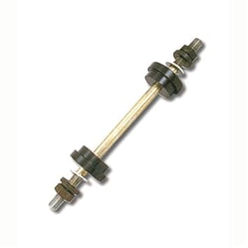

Needing all 3 tools depends what you have or can do without
Here's some manufactures link...do a search(web, Amazon, Ebay) and get your best deal
Steering Stem Bearing Tool for HD (REMOVES and INSTALLS)
https://www.motionpro.com/product/08-0558
Steering Head Race Puller
https://www.motionpro.com/product/08-0545
For cggorman's installer, search for Jims 1725

So i will need
08-0558 or 08-0554
08-0545
08-0550
is there a tool required for stem adjust nut 4 in attached pic ?
