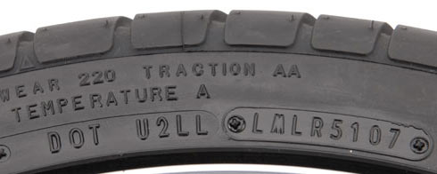

Since 2000, the week and year the tire was produced has been provided by the last four digits of the Tire Identification Number with the 2 digits being used to identify the week immediately preceding the 2 digits used to identify the year. The picture shown below show a tire manufactured in the 51st week of 2007. Most tires, if not subjected to a harsh environment, are usually good for 4 - 5 years.
Good info for the war basket. Thanks.
Look for this when you buy new tires. You'd be surprised how old some tires are when you buy them new. Someone tried selling me 3 year old tires for my car one time. I wouldn't take anything that was not produced in the current year, or 1 year previous at the most.

Tires show no sign of cracking and look to be in good shape. looking at the date stamp they were made late 07. thanks for the info!
