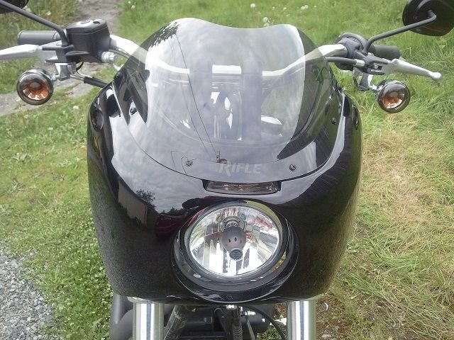

The bubble screen on mine before a desert ride convinced me to go higher. It's 5.5" at the center.

quick release clamps are what I used. all I have on mine are the top mounts on the quick releases and the bottom bolt that runs thru the stand off that's part of the headlight relocation. youll be golden dude. and it comes with the headlight "relocation" ...its just a small block that bolts in between your headlight mount and your bottom tree. keep 2 of your quick releases and it comes with everything else you need brother.

it doesn't have provisions to mount it with 4 quick releases. youd have to drill the fairing itself and use some more collet struts. its totally unnecessary, two on the top and the bottom mount are plenty. ive got 5000 miles on mine already and ride 85mph+ daily with no problems.
