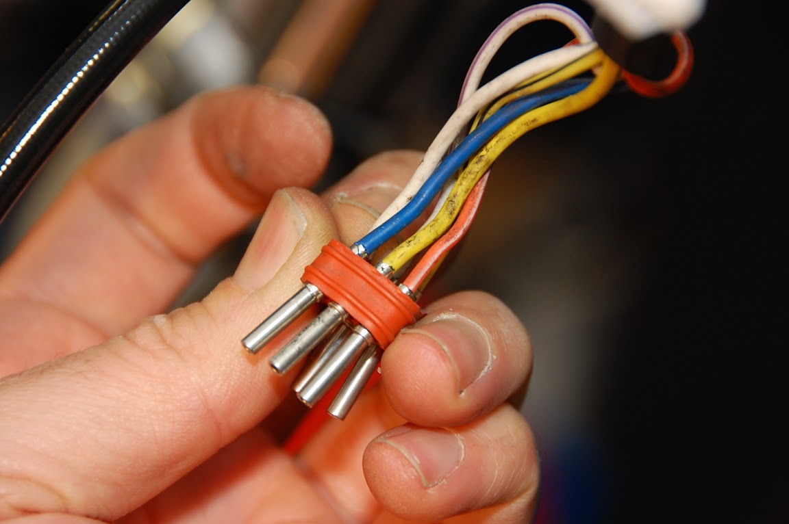

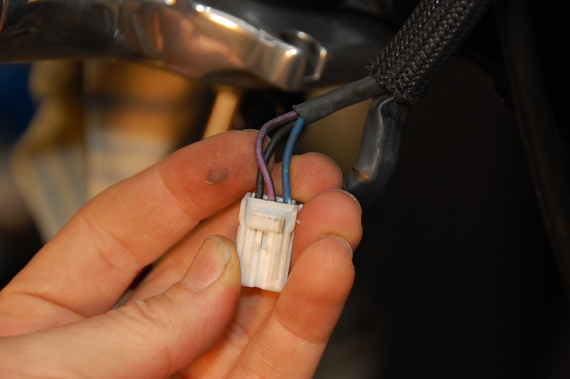

If the T-bars are not dimpled, then they're drilled. (right?)
You need to disassemble the connectors at the end of the wires to allow you to thread the wires through the bars. Take pics or detailed notes so that you can get the right color wires in the right places when you re-assemble. I used a tiny jewelers (eyeglasses) screwdriver to help me get the plugs apart. it is tricky to get the wires to slide out of the plugs. You have to take your time and slide something skinny in where the metal cap at the end of each wire bites into the plastic housing.
Here are some pics from when I removed my apes. They might give you some idea of what to look for. Find those threads that have the detailed write-ups on how to get the plug housings apart. They will help.
