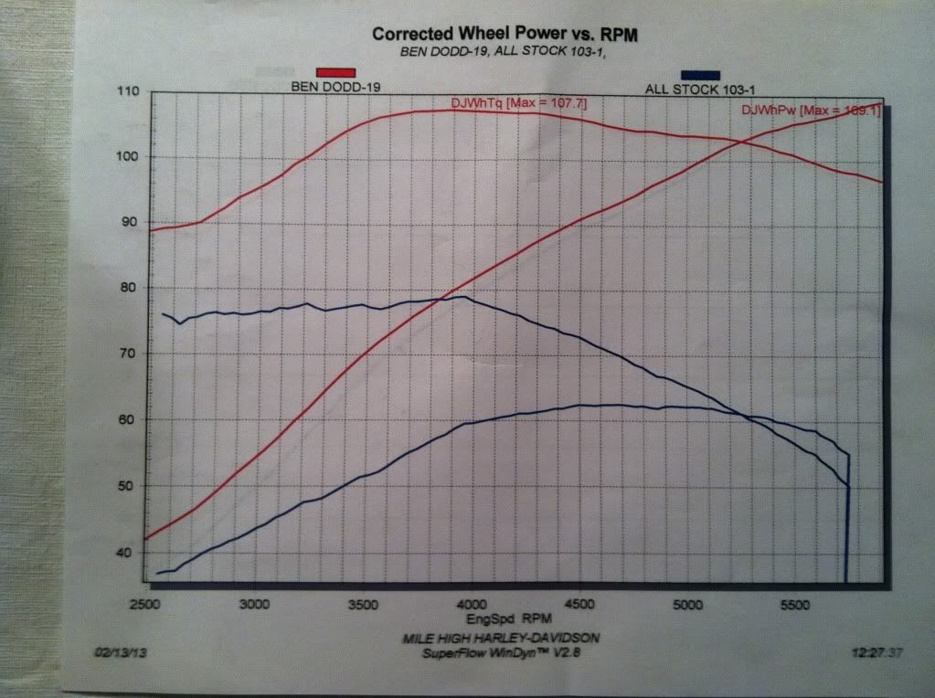

Thanks. Nice looking bob Friso. Had to fabricate some brackets for the fairing, the brackets that came with it don't work with the FXD style trees... they are for the older FXR trees (had I known this I would have just gone with the Ness wide glide fairing). The fairing attaches to a headlight relocation bracket on the bottom, and attaches to the pinch bolts on the trees on each side. Yeah, just a standard 5 3/4" housing, with LED light.
Just got the dyno results... 109 hp / 107 tq
