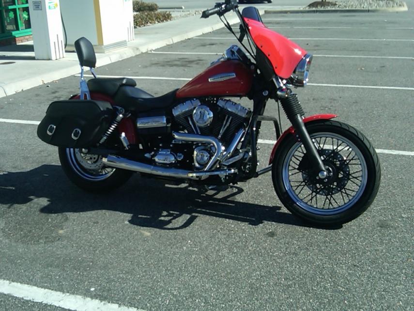

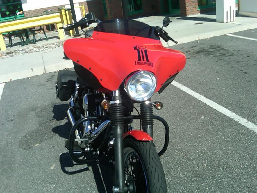

Finally got around to installing the rest of my winter mods and took a few pictures so I thought Id share.
The lastest mod was the FLD Rider floorboard kit. Pretty simple install. Had difficulty getting the rear brake rod out of the master cylinder. The rod actually ended up braking off and I had to buy a new rear brake master cylinder. I cut the mid shifter shaft off when I installed everything.
https://www.hdforums.com/forum/dyna-...g-primary.html
I also added a washer as a spacer between the frame and the exhaust side mouting bracket. I needed a little extra clearance to get around the exhaust. It mounted up fine with the exhaust but any time the bike moved it squeaked.
Before that I added the Basani 2-1 exhaust. Again, a pretty easy and straight forward install. Having the extra set of hands helping out, difinitely made it much easier. Had to contact Bassani, as did other forum members, to have a new rear mounting bracket made.
Also added more bolt on items: saddle bags, taller sissy bar, mustang solo seat and passenger seat, and harley decal on the fairing.

Bike looks GREAT!! Is the fairing easily detachable??
