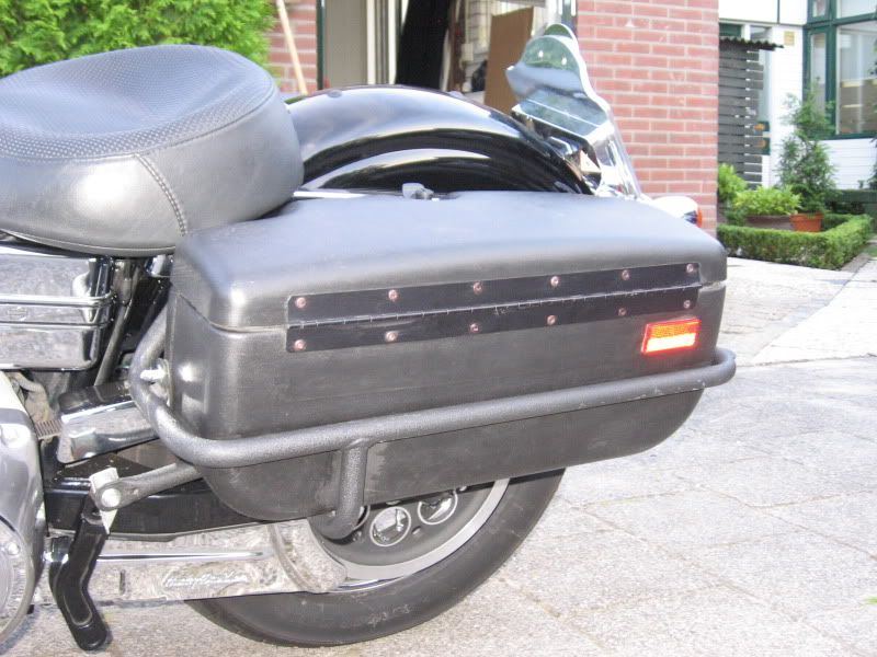

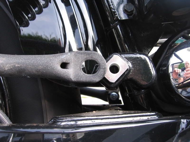

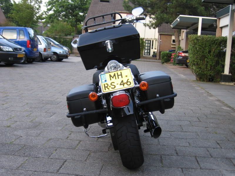

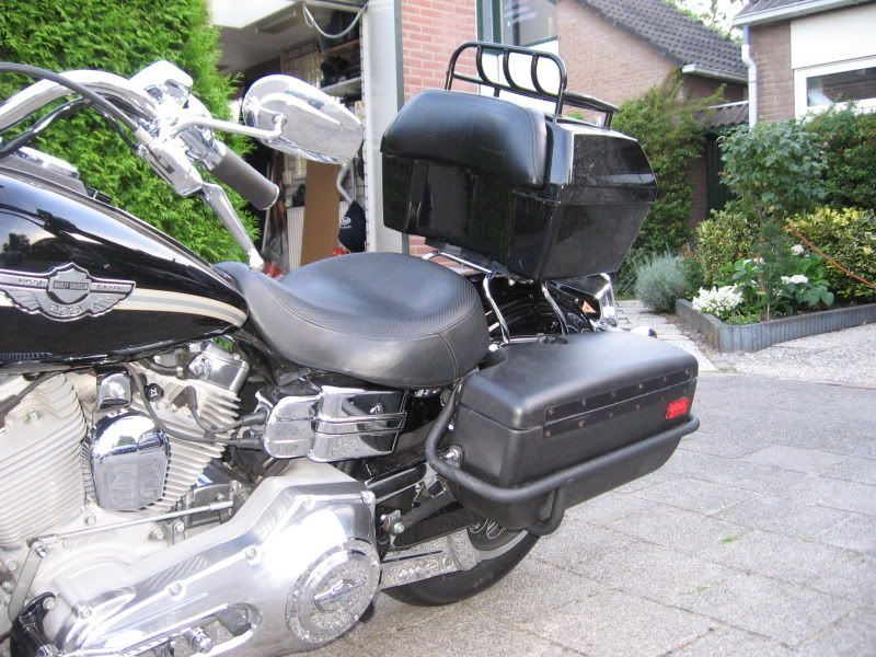

If you're talking FXDP bags, you might try searching on posts by FXD2003Rider. Rene installed them on his FXD three or four years ago and he left a really nice write-up about it on this forum. As I recall, he fabbed a brace himself.
I have an '04 FXDP and that heavy brace is essential if you're mounting them with the cages. Otherwise, the fender will flex badly as that's a critical mounting point. And it is not even shown on HD parts catalogs for the FXDP. Must only come with the complete FXDP fender. Probably wouldn't fit your fender even if you could find one.

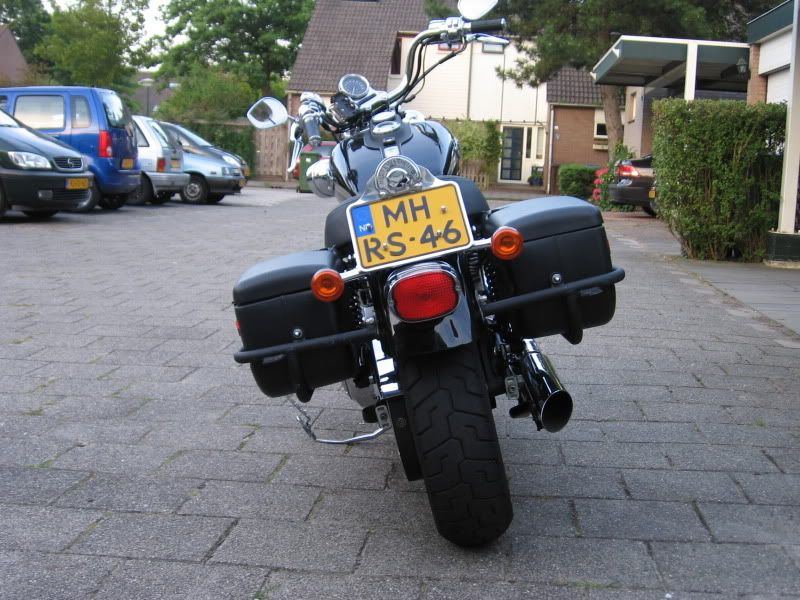

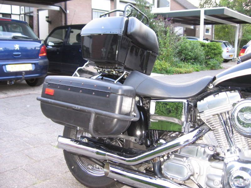

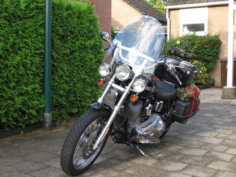

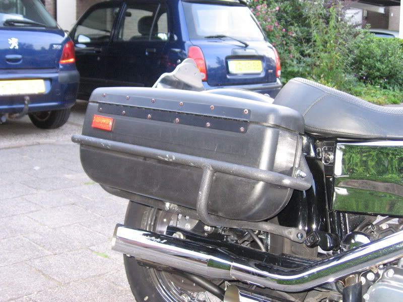

As an addition to my previous post a link to my PhotoBucket folder & some images:
http://s695.photobucket.com/user/FXD...ardbags?page=1
