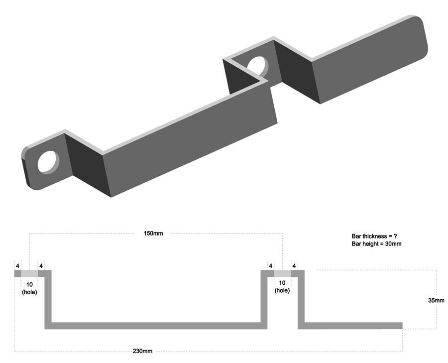

Funny, I was just looking into the same thing yesterday.
I don't need to remove mine, so happy for them to be bolt on (security bolts, obviously!), so I've designed my own bracket and found a local metalworker/fabricator who's gonna make them up for me.
I'll post the results, but here's what I've designed...
