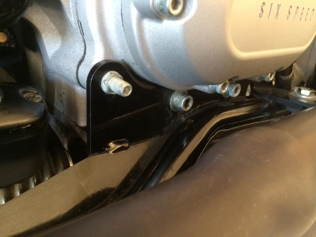

I've been running my thunder header for about 4 years now with no issues with the mounts. However the other day my step brother was giving me a hand with the bike and he noticed that I had mounted my bracket to the trans different than he did. The rear bolt with the stud on it is the bolt I'm concerned about. You can see I used it as a regular bolt, and (sorry no pics) he screwed the bolt into the trans first, then mounted the bracket on the stud portion of the bolt and secured with a nut. He just recently bought his theader, so I'm not sure if they have changed the mount or if one of us mounted it wrong. How did you mount yours?

yours is mounted correct it sets flush against the case .the other way with the nut behind bracket is wrong.
Right in that's what I thought thanks man. Your bracket seems to have a lot more weld on it than mine. Wonder if I sould re weld that when I have the pipe powdered

This is where my OCD takes over......Change that stud/bolt for a proper matching bolt!! I know I know, but geesh, a bike can look so much cleaner with proper hardware.
I even changed the rear mounting bolts to stainless button heads, the T Header bolts supplied were terrible.
Lol I was going to do exactly that until my brother said I had it mounted wrong so I held off! But yes I will be replacing both of those bolts just for you friend!
Using the stainless button head bolts installed from the swing arm side allows much easier mounting. Just use a magnet to hold the nut in the T Header until u get the bolt started. When I got my bike the fella had long bolts installed on the exhaust side and they were so long they hit my swingarm! (14 inch shocks)
Glad I have a great bolt supplier 3 miles away.
