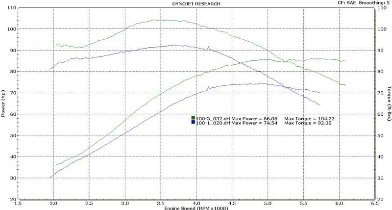

You can't go wrong with the 204's they are an incredible gain over a stage 1. There is power everywhere and too spare. I still wish I had at least 20+ hp and ft/lbs more. I will I admit I have a problem with power and I've been corrupted by 180+whp bikes.
https://www.hdforums.com/forum/images/icons/icon10.gif
91.69HP 104.56ft/lbs
