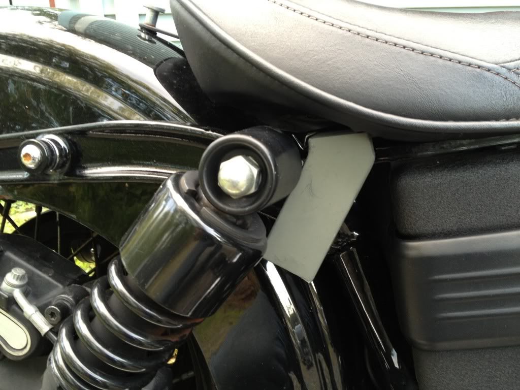

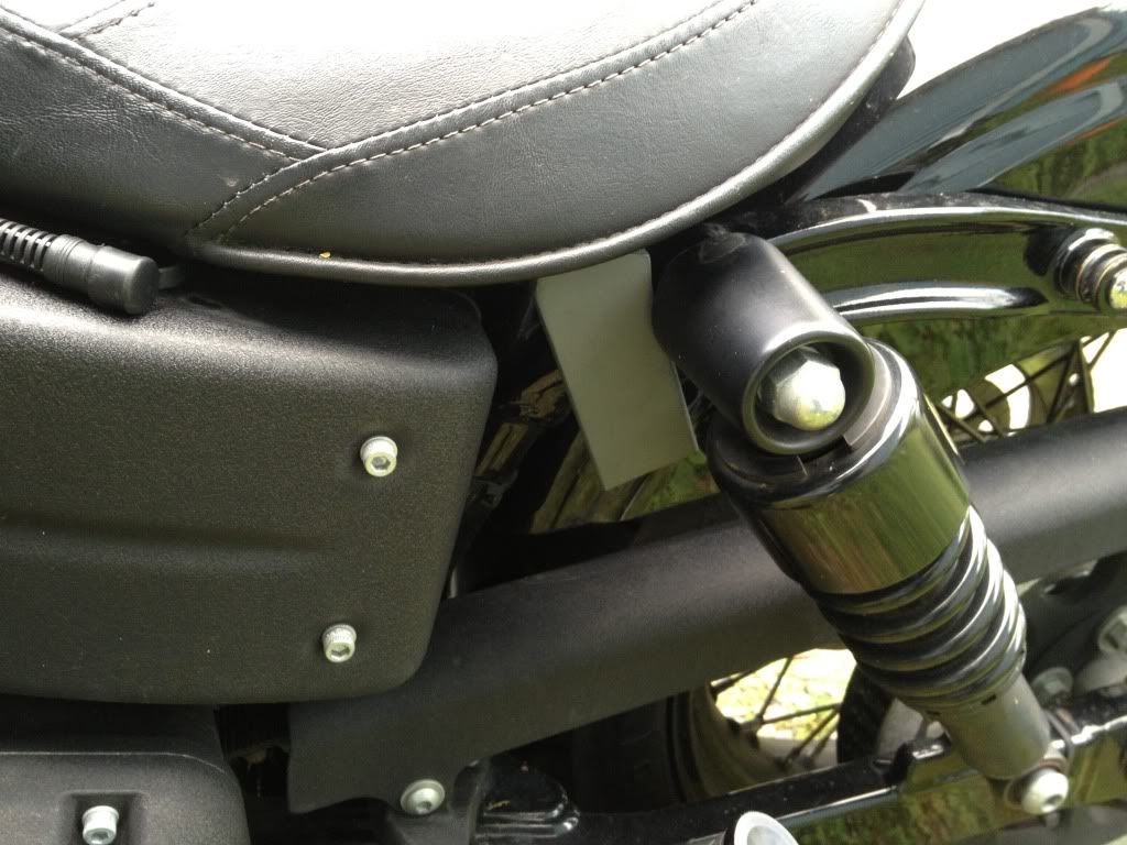

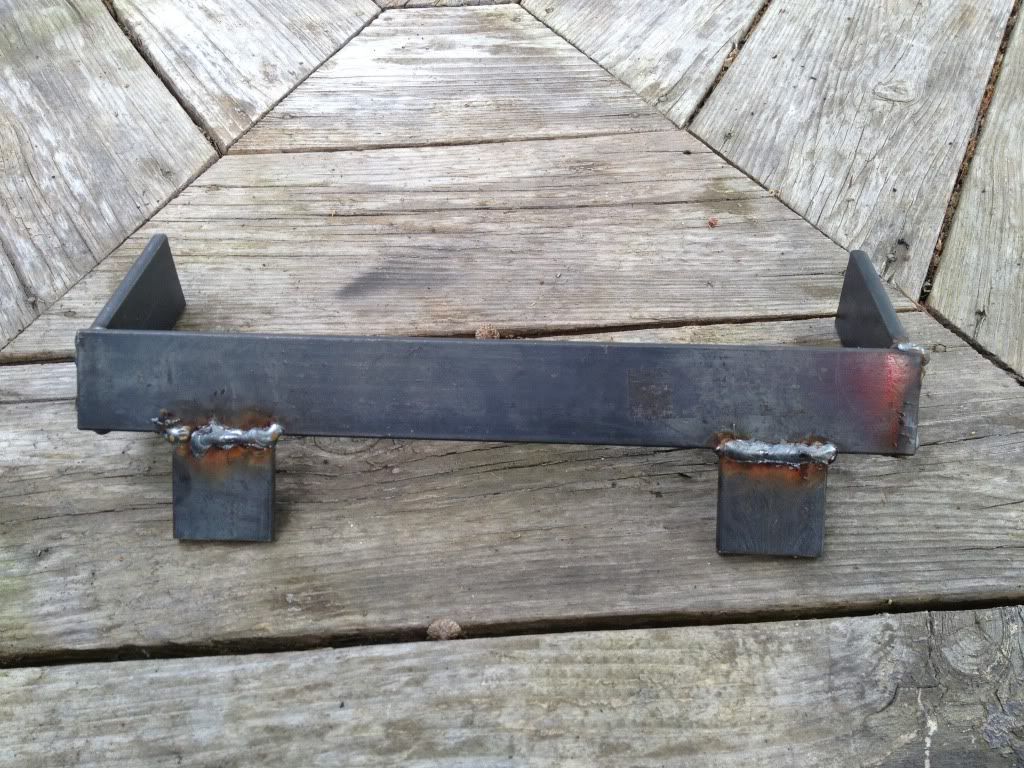

I don't use the CV kit because the guy pretty much told me to go F myself because I was modifying my own bags and just wanted to purchase the under seat bracket. He said to either fab up my own or find someone else to do it. Anyways, that's a different story. I built up my own using 1/4" flat bar, putting on the stock Street Bob seat did take some work and ended up breaking the point where the seat tab connects to the seat from the stress cause by the gap between the seat and fender due to the bracket. I know use a Mustang solo or a two up, both work great with the bracket. When I made the bracket I noticed the same thing you ran into with the two arms hanging over and hardware possibly causing damage. So I angled the arms back to flow this the shocks and they clear everything. Here are some pics, these are from mock up, mounting holes have been added and I have been using it for about a year or so, no issues.

That's EXACTLY my problem .... My stock 2 up superglide seat will go on but I have to bow it up off the fender and it seems like it could stress it enough to eventually break it ... I also have stock street bob seat and I'm pretty certain that I will rip the mounting tab off if I force it down ...:.. It really is kind of a shitty design in my $269.00 opinion.
I don't think there is any reason it needs to be so damn thick , I'm pretty certain that the fender strut bolts carry the lions share of the weigh and that's more of a stabilizer ... It really sucks to spend that much $ on something and still have to "make it work".
I don't know if I need to rethink how that bracket works and build it to better fit or modify my seat ... Thought about trying to heat seat pan up enough to somewhat mold/ contour it to better fit the bracket .
