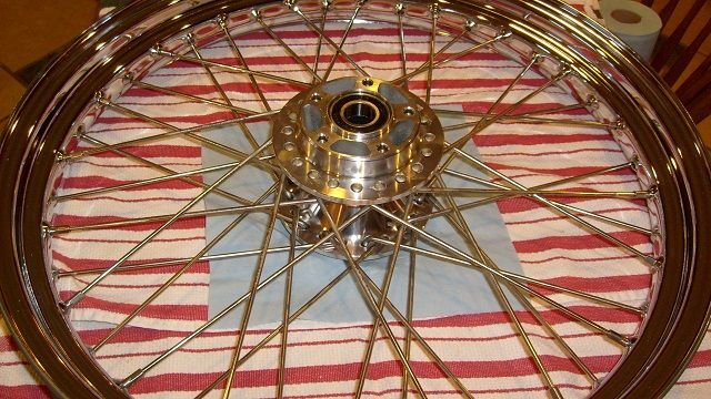

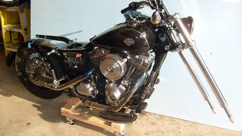

Got all the spokes for the 23" rim polished this weekend. Now I need the front axle and brake disc off the existing wheel.
So... built a dolly for the bike. Rigged up a hoist and lifted the bike onto the dolly. And then got to stripping parts off.
Test fit the +2" forks.

Thanks - it was a fun afternoon. The bike sits on the front tubes and a large casting at the rear. It would take lot to knock it off the dolly, but I still need to find a way to strap it down.
The hoist involved necessity, invention and a lot of unintended uses. I can't go into details.

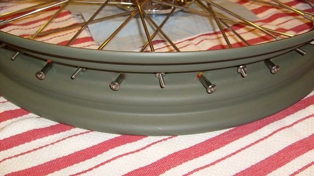

New bearings installed, spokes polished, and my first attempt at lacing up a wheel. Nice!
Except.... the spokes are too long! Grrrr. Time to give Buchanan's a call. Grrrr.

Quick response from Buchanan's! I had the spokes laced crossing three instead of crossing four spokes. Relaced and ready to be trued. Threw on the spacers and the discs for a preview. That's one big pizza cutter!
