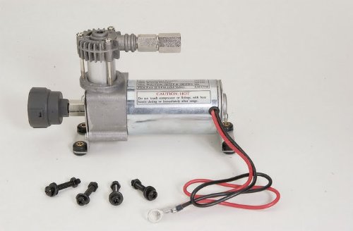

What did you use for the top shock purch? Are the shocks a small diameter then the stock shock?

Joe, Is there a filter that is supposed to screw into the side of the air compressor? Are you just not going to run this part? Any side effects to doing that?

Another question... when you powdered the shocks and the compressor, did you not have to completely disassemble them in order to avoid melting any of the seals inside of them?
I am running the air filter, really quiets it down! i ran a 90* push fitting for 1/4 and then added a 1/4x1/8pnt push fitting on the filter itself... this let me route the filter anywhere i wanted and not have to have it scewed into the side
shocks and compressor where all painted, i tore the compressor part way apart and coated a good amount of parts on it, but the body of it is all paint.
a while back i snapped my top shock bolt and lost the spacer... HD wanted like $65 for a new one so i just made my own on the lathe, once you swap bushings the mount locations are like stock, the overall diameter of them is smaller than stock by a bit yes
