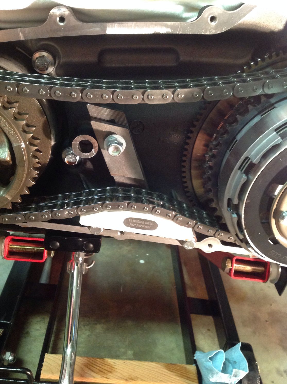

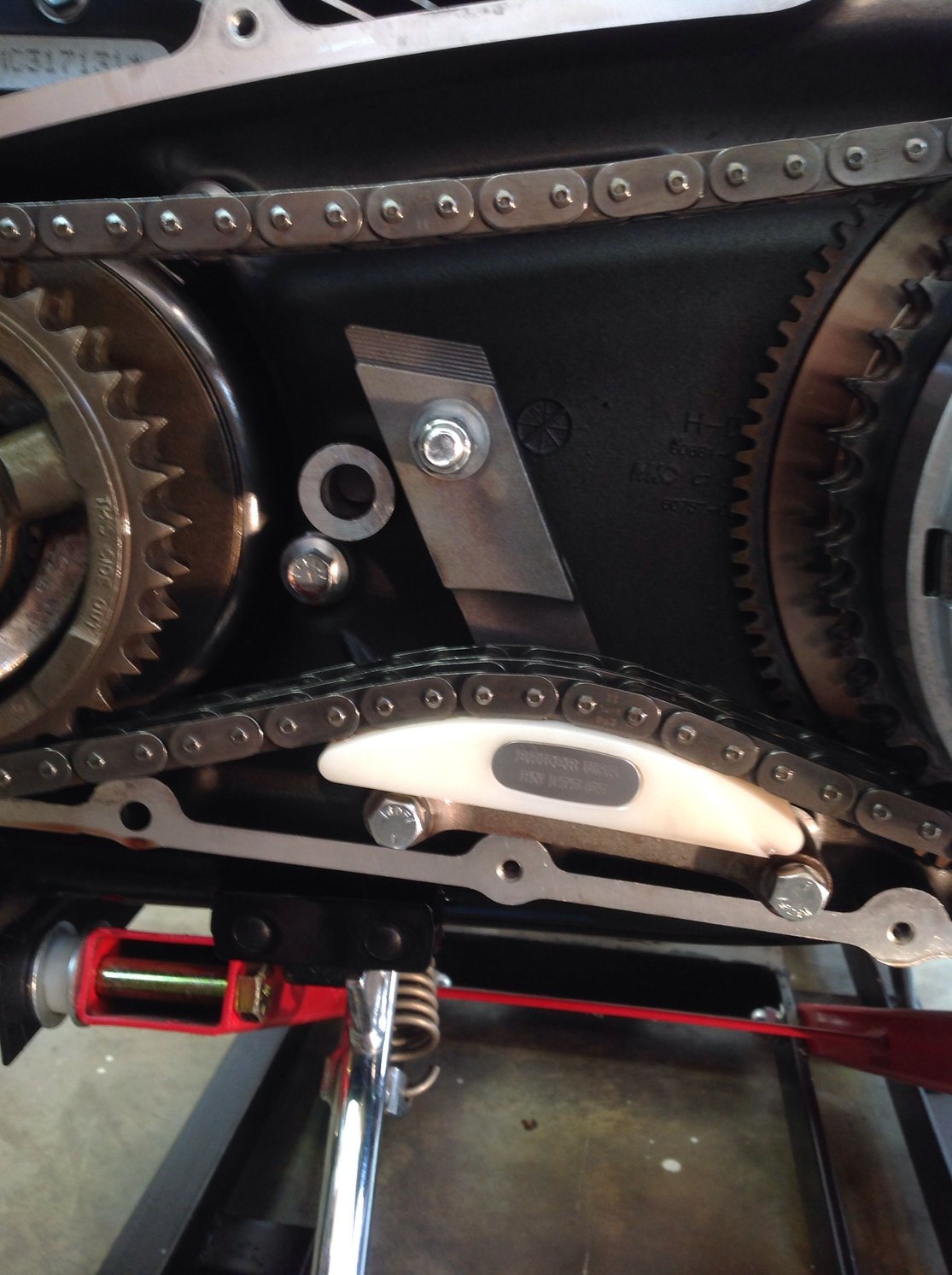

The Baker install is pretty easy with the primary chain loose, you can rest the compensator sprocket on the kickstand and slide the Baker in. Reinstall the compensator sprocket with a new bolt and torque down the 2 screws that secure the tensioner all to HD specs:
Now you want to adjust the Baker to a 5/8" to 7/8" upward chain deflection and check it over several different parts of the chain, then torque down the adjuster screw:
