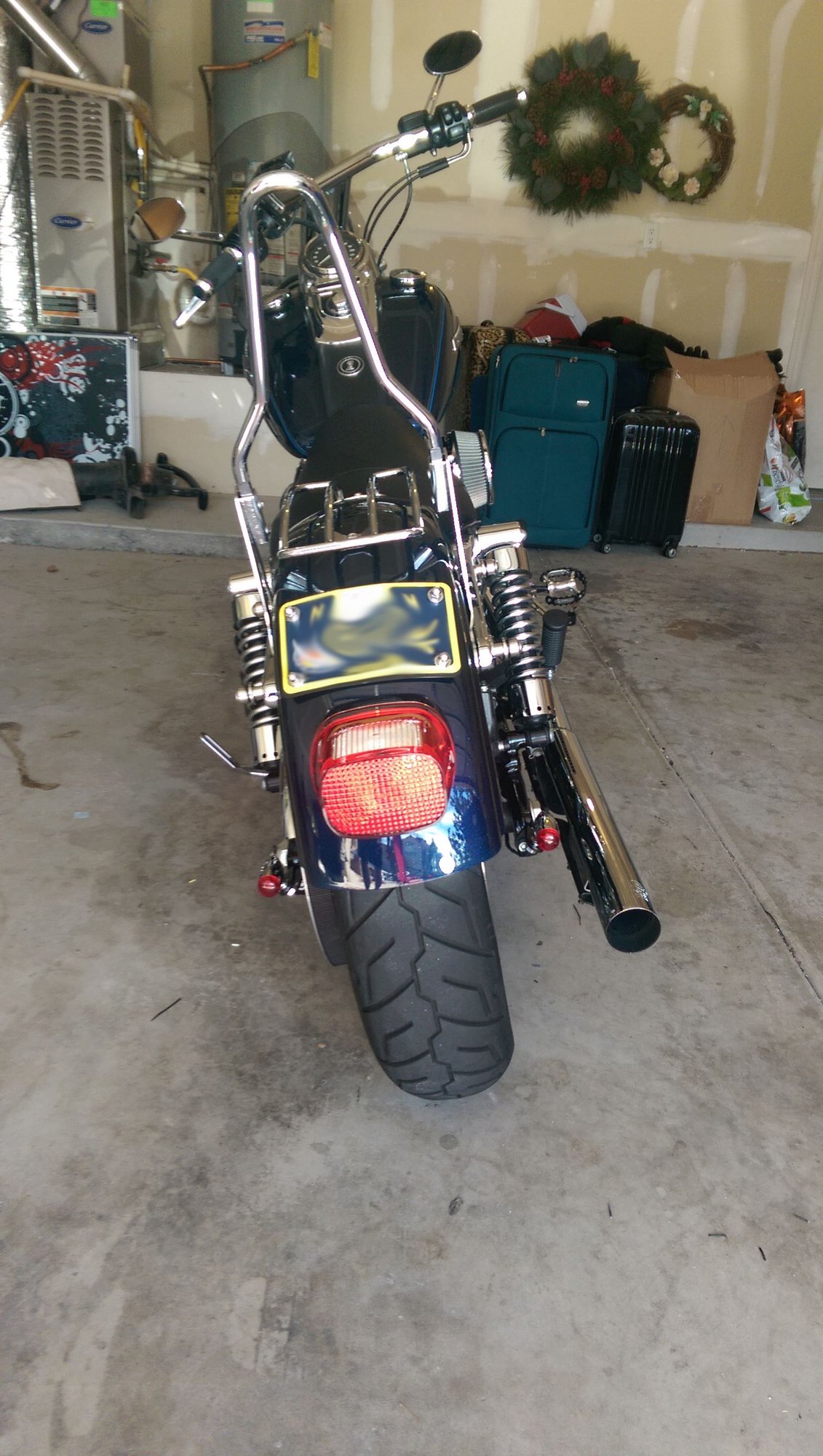

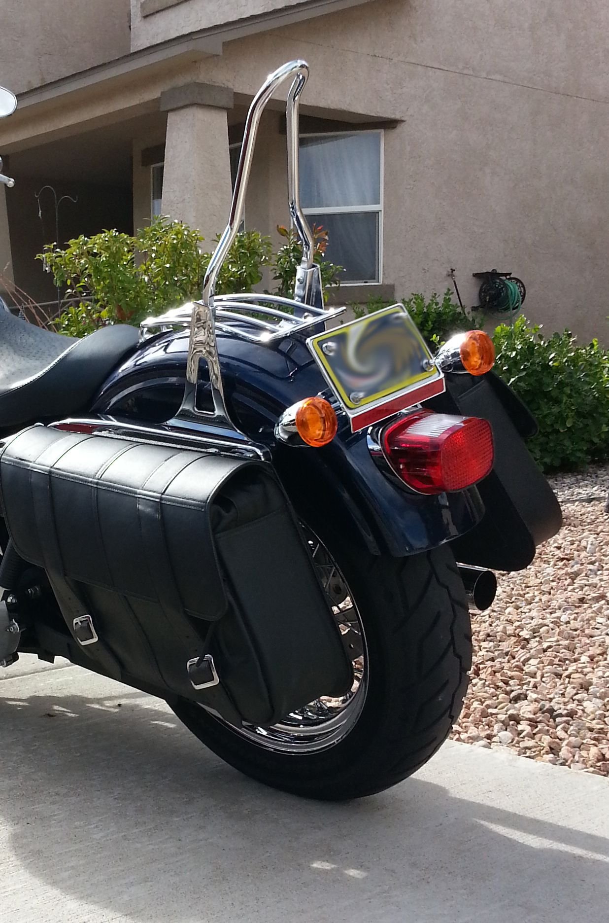

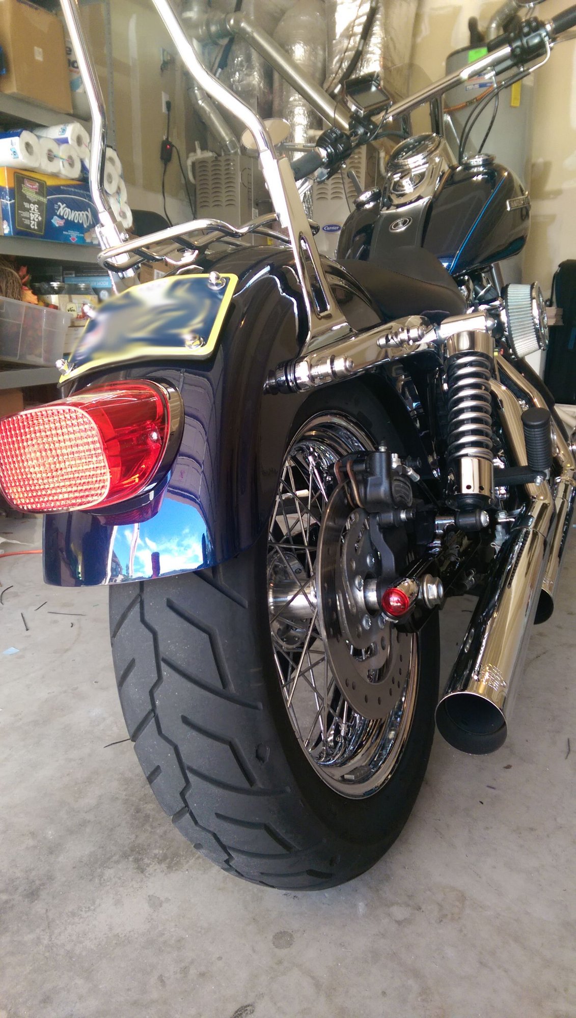

before...
after...
I think they came out pretty nice. I had the harley lay down plate relo kit for a bit but really like the way this slimmed down the backend.

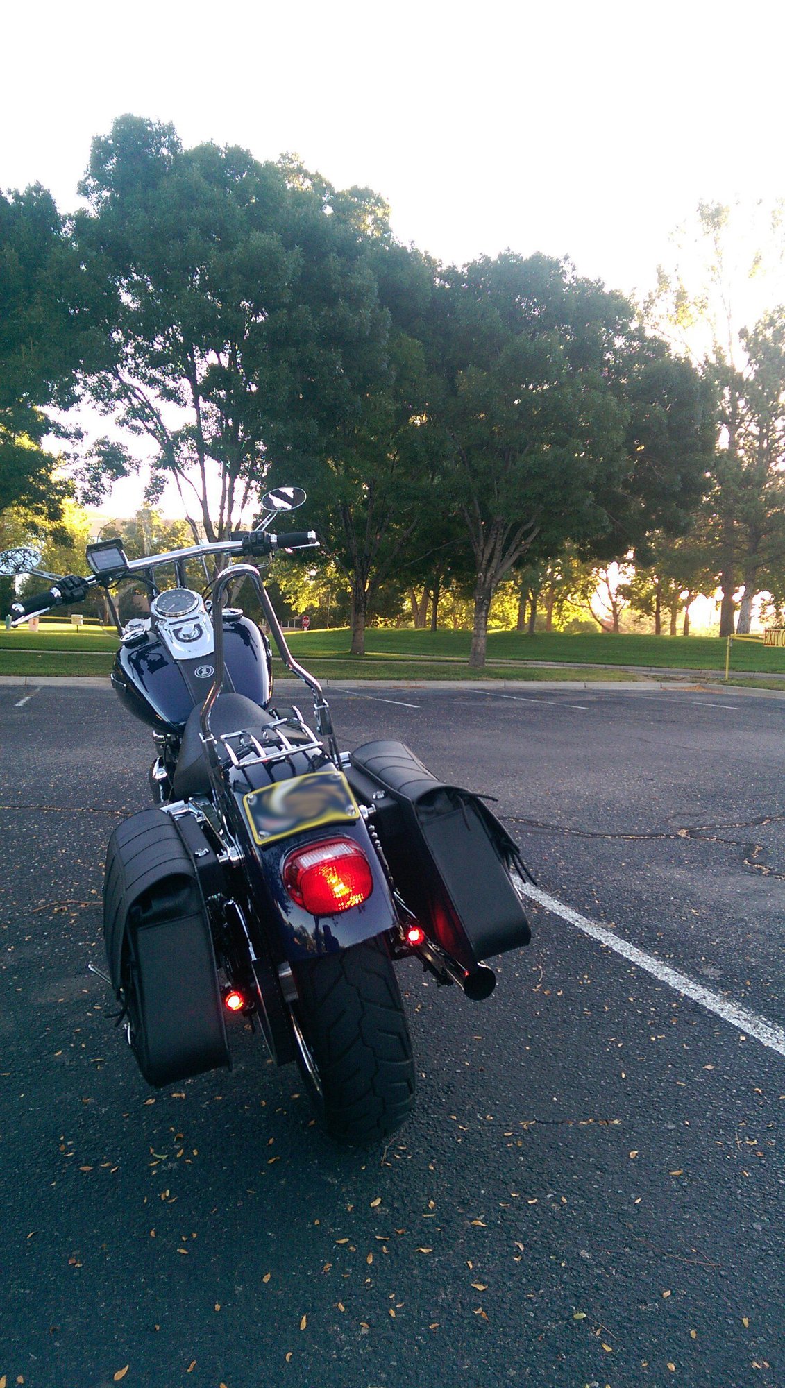

Originally Posted by WMX124
Are they visible with your bags installed?
Here is a pic with the bags installed. I'm sure I lost a little visibility but did gain the extra lighting now that they are running lights as well. I will probably add a brake module down the line as well.

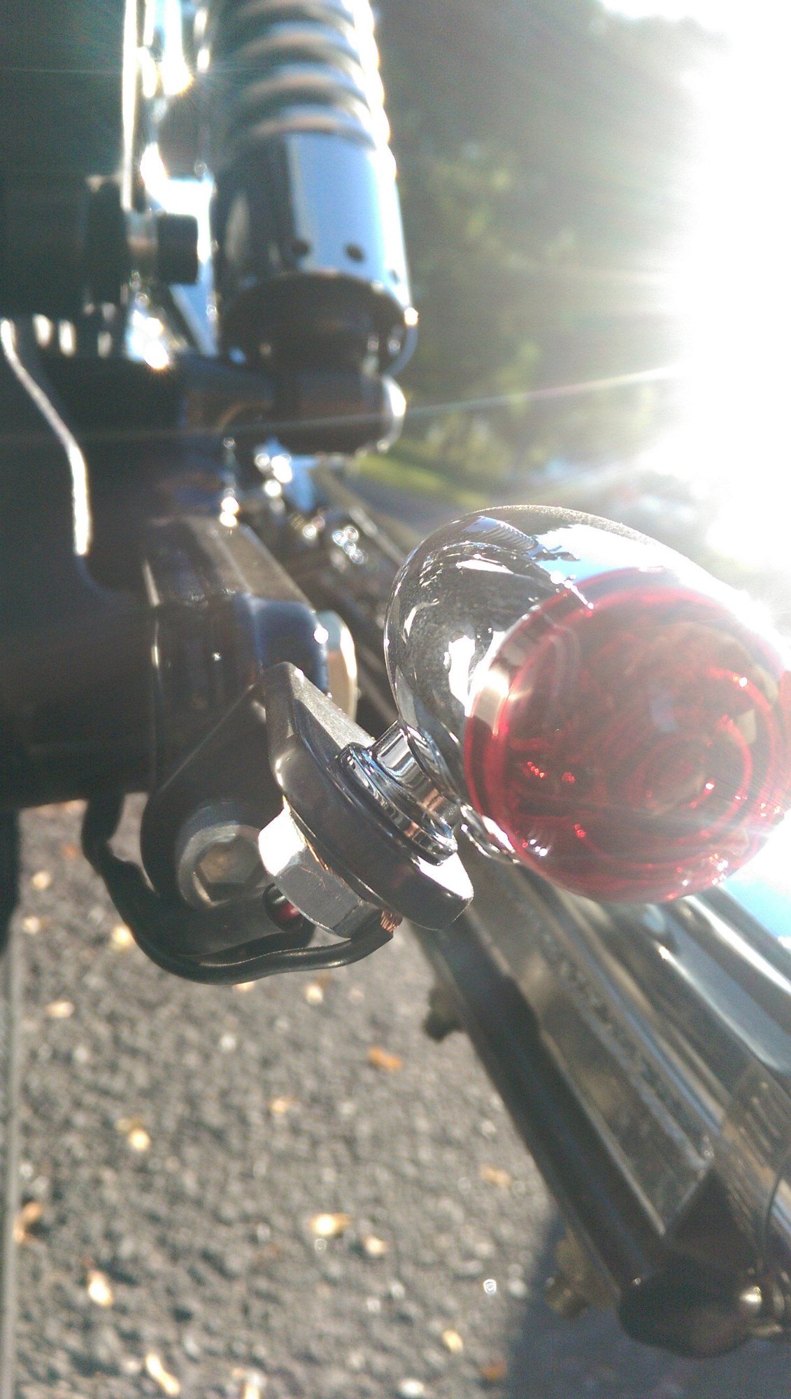

Originally Posted by blueangel73
Looks good. Do you have an profile shots or view of how they are installed.
Here is a close up of the install. They are "L" brackets connected to the belt tension adjustment bolts. I just ran the wires along the swing arm and up the frame to under the seat.

Originally Posted by SuperFastGlide
how do you tighten the bolts without affecting the belt tension??
I relocated my sigs to a shelf in the garage, best relocation ive done so far
The bolts they are attached to are used for getting the belt tension correct but the actual wheel is held in place with the axle nuts. Once the axle nuts are tight the axel adjuster nuts really don't do anything. I did torque them back down to specs which is 96-120 in-lbs.
