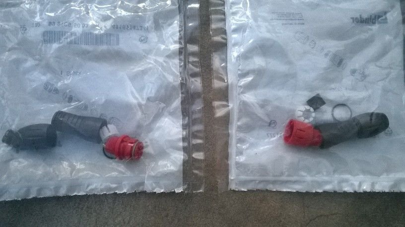

Originally Posted by Vandinroth
....I'm tempted to just get the wires out of both sides of the connector and rewire on a simpler connector. Any legit reason *not* to do this?
As long as what you come up with doesn't compromise the protectiveness of the original connector against the elements.
Just make sure the connectors you source have the highest IP rating you can get to prevent moisture ingress. I sourced and used some IP 68 ones recently for the Drag Specialities LED tail light I fitted instead of cutting and splicing the wiring. If you make a good termination and do not alter the resistance value of the circuit, canbus or not, it will not make any difference. The ones depicted below were the solder variety.
