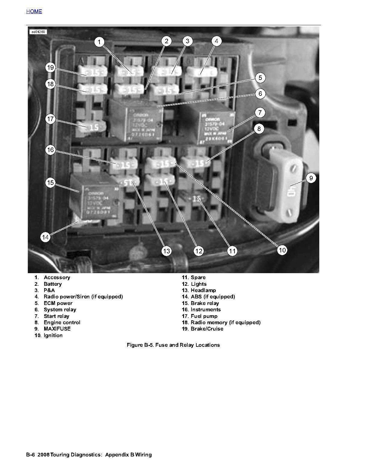

is there anyone with a 2008 street glide that wouldnt mind taking a close up picture of their fuse panel?thanks,i need to check some fuses and relay position

what happened to the picture?
