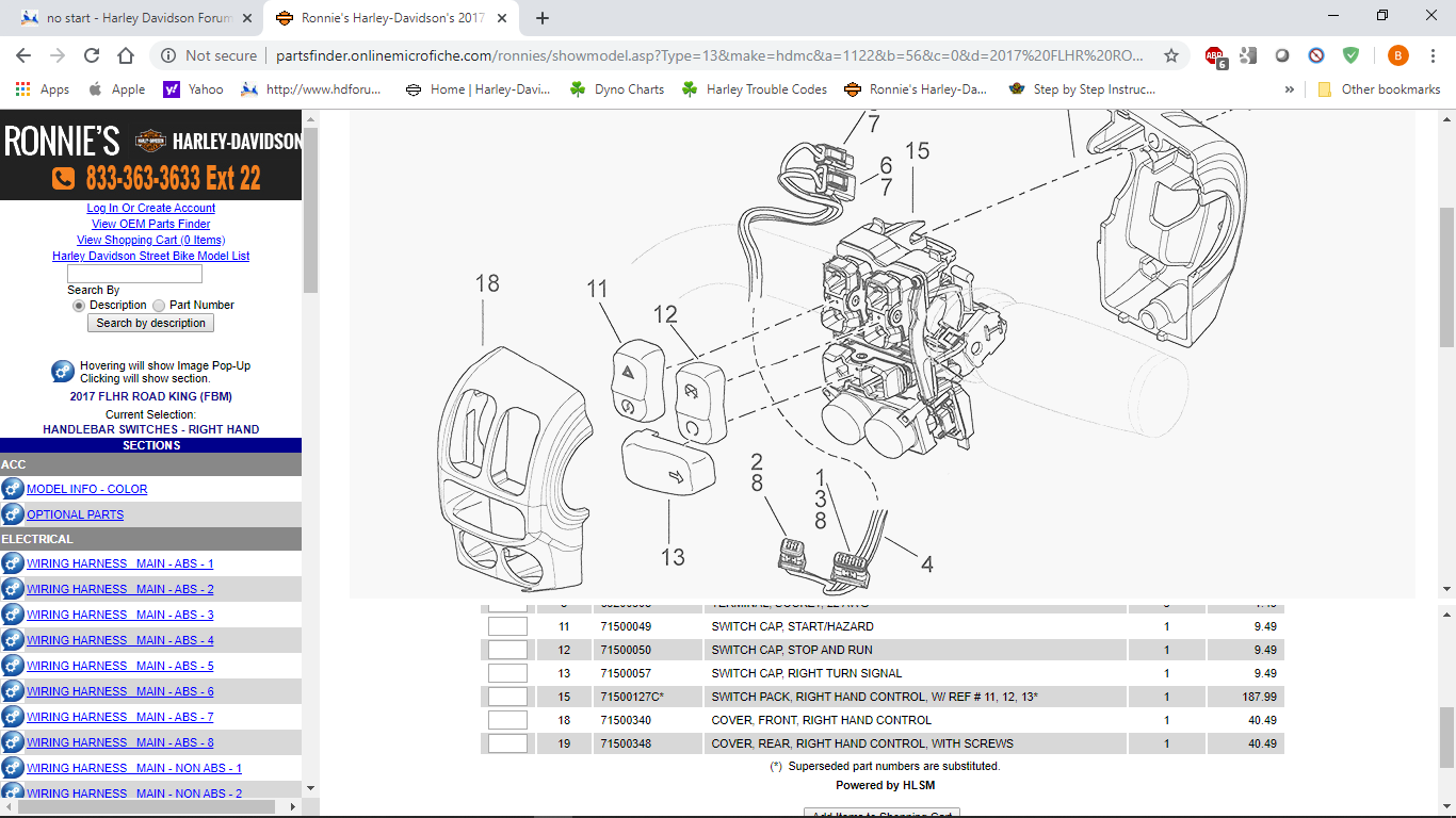

2017 Road King will not start in gear, will start in neutral, I have seen this here before and looking for the fix.will i need part # 71500419A ? the right switch pack # 71500127C I have issue with front brake light and cruise shut off with front brake

I would suspect the LEFT switch pack...

The electrical manual say's if a switch sticks for 2 minutes it will set a dtc. Clear the DTC and if it returns replace the module. Seems like I've read other posts where some have had good luck spraying a little WD40 on the switch. I'd try that before I spent $400 on new modules.
Your part #'s for the modules looked good.

Thanks I did spray the button, i will check for codes also.
