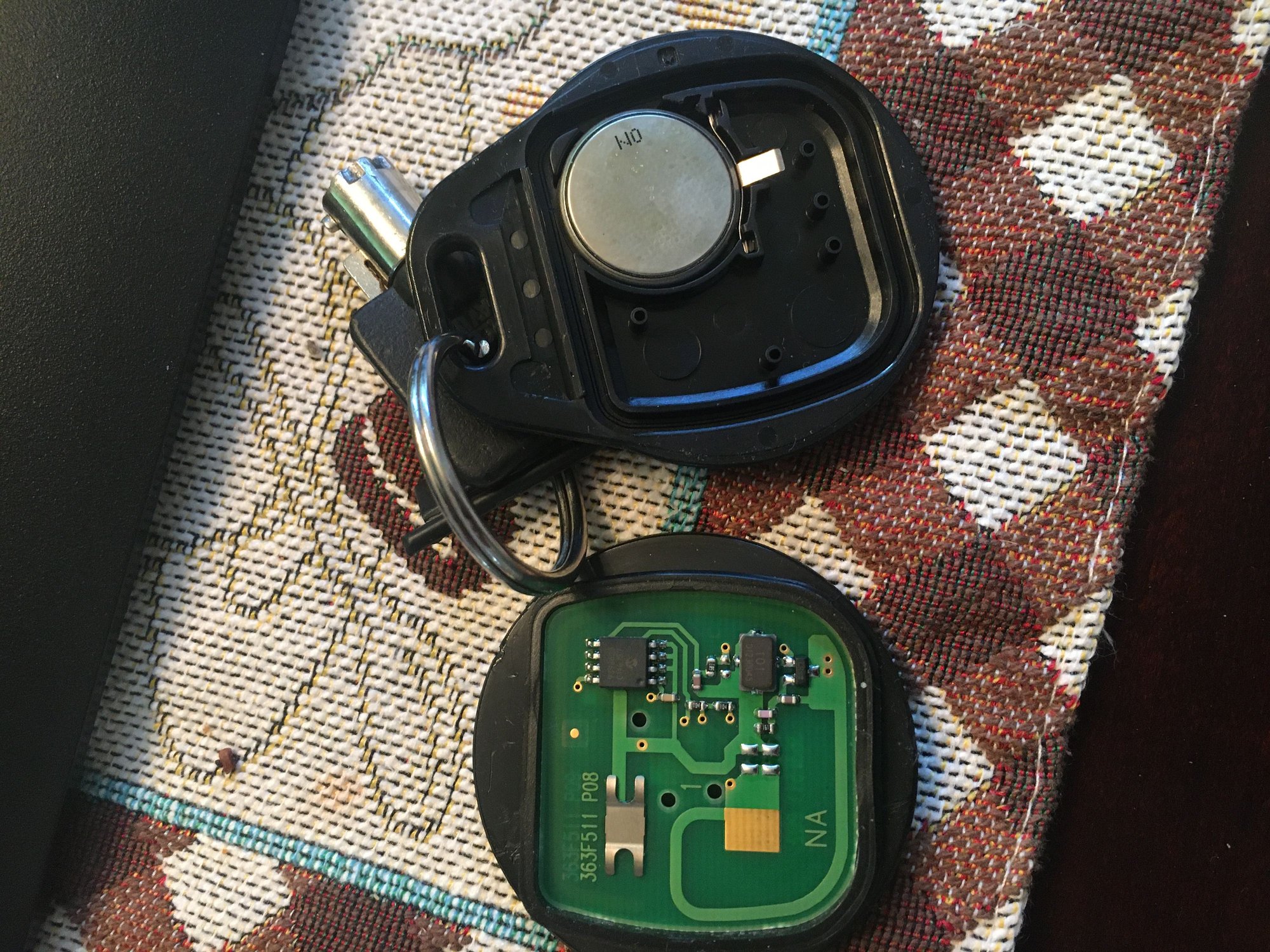

Rick,
can you open your fobs and send me a pic like this?

Hi Ed, sorry I cannot as I left them in Florida. I had them apart to check the batteries and they look exactly like that.
im looking for a number. They will look alike at a glance. You have a domestic TSSM and if you have HDI fobs they are on a different frequency.
