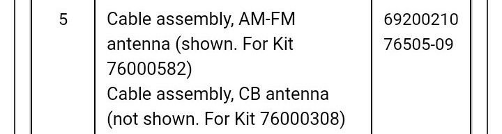

The issue I am having is locating the correct cable specific for the CB. Only one place shows avail, but they want 100$ for it plus another 48$ to ship it.
Cable assembly, CB antenna (For Kit 76000308) 76505-09 - shown as number 5 in the top illustration.
That part is showing up on Surdyke's website. Give them a call to confirm availability.

Hey Barney,
Nice find. I also located and ordered already from Inter-Mountain HD out of Utah. I've ordered a bunch of stuff through them in the past.
I'll know soon enough if this will work.
Ordered:
76000582: AM/FM relocation kit
6505-09: CB Cable Assembly.
I'll just omit the AM/FM cable and use the CB assembly. Seems easy enough!

UPDATE:
Received my parts today. Worked flawlessly and looks clean too. Other than ending up with an additional cable the parts did the job.
Parts needed:
AM/FM Antenna Relocation Kit
76000582
CABLE ASY,CB ANTENNA
76505-09
Now if HD would only just offer CB ANTENNA RELOCATION KIT Item #: 76000308 you wouldn't have to go about it this way. Seems they have it on their 2020 catalog but no way to buy it. Those that advertise it want well over what it's worth and others have no stock or claim its a special order item.
