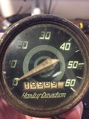

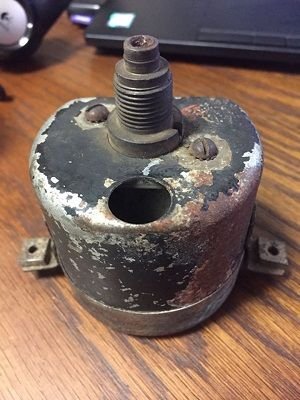

Trying to find out just what this thing I have is for. Clearly a Harley Davidson, but which year model?
Strange the limit is only 60 MPH. Can anyone offer some advice or share their knowledge?
Face View
Rear and side view

it`s from a Hummer light weight 125cc
p/n 67000-51A
the 165cc versions go to 70 mph

Gauge diameter is 2-3/4"

it was used on many models including the m50. very early 60's for sure and maybe back into the 50's as well.
