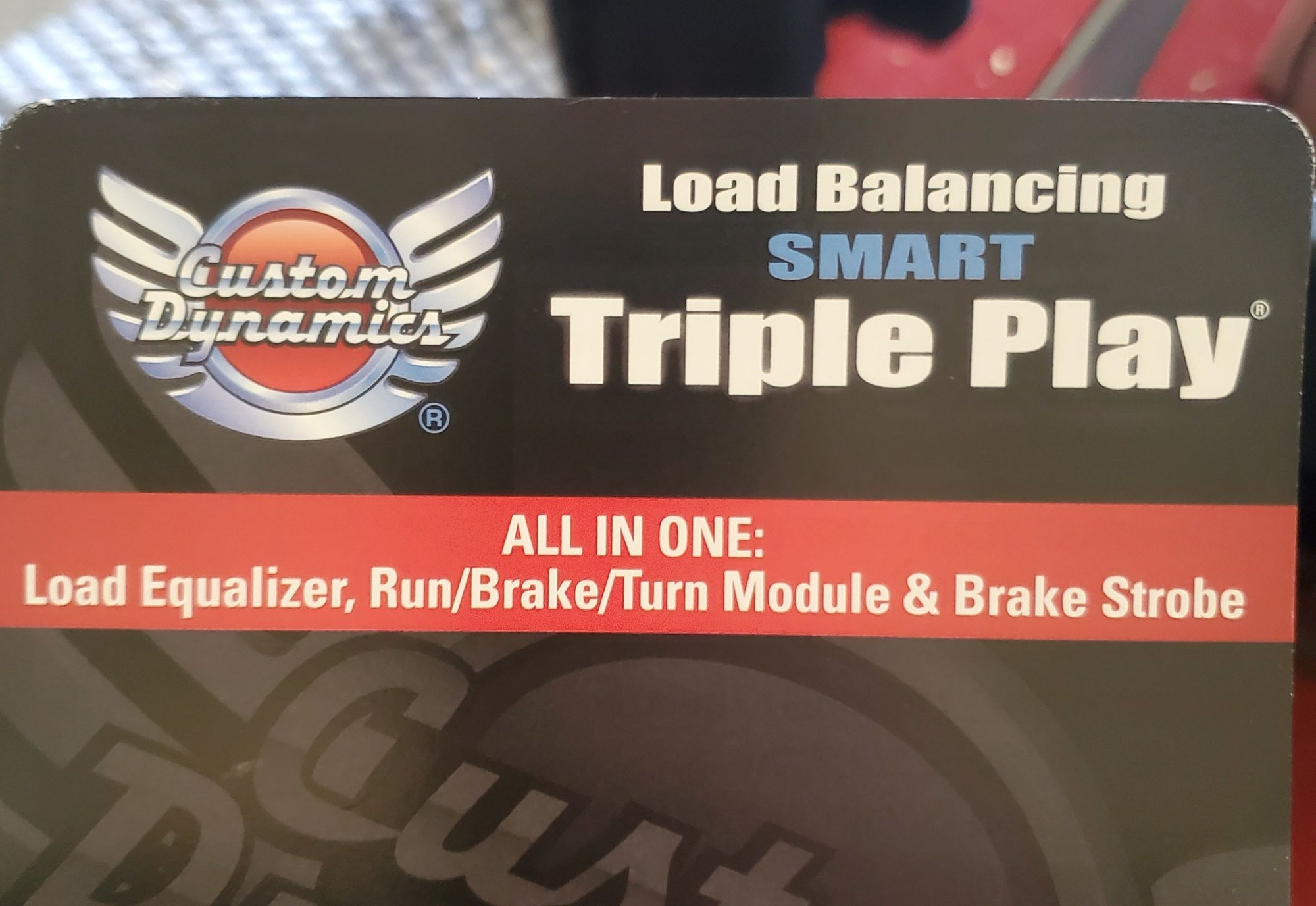

Does anybody know what the bigger box that's wrapped between the two connectors is and if it's easy to find and replace? I've been having some brake light issues and whenever I press down hard on the box my brake lights will go out but if I move it around they will turn back on. Thanks!

Thank you guys for the input! It was run/brake/turn module. And the reasoning for all the tape around the box was because it was an aftermarket piece and it was holding two boxes together. Makes sense now. I picked up this all-in-one module. It was a little more expensive than I expected but not only did it fix the lights but I now have strobe brake lights and solved my hyper flashing issue at the same time :-) I'm ****ing happy and glad that's over. Haha

Good choice
Custom Dynamics has some good products .

I run the triple play on two of my bikes. Good product.
