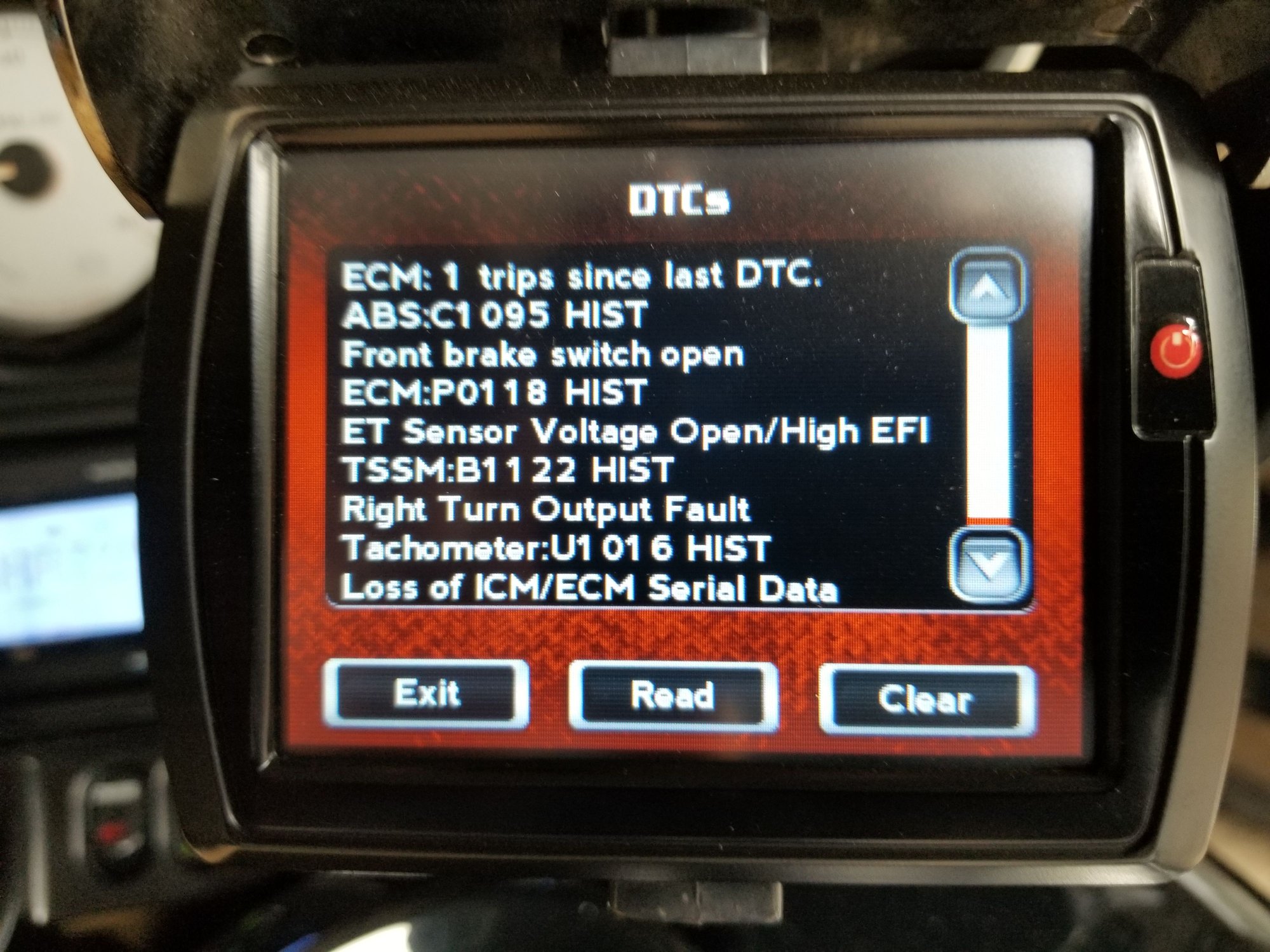

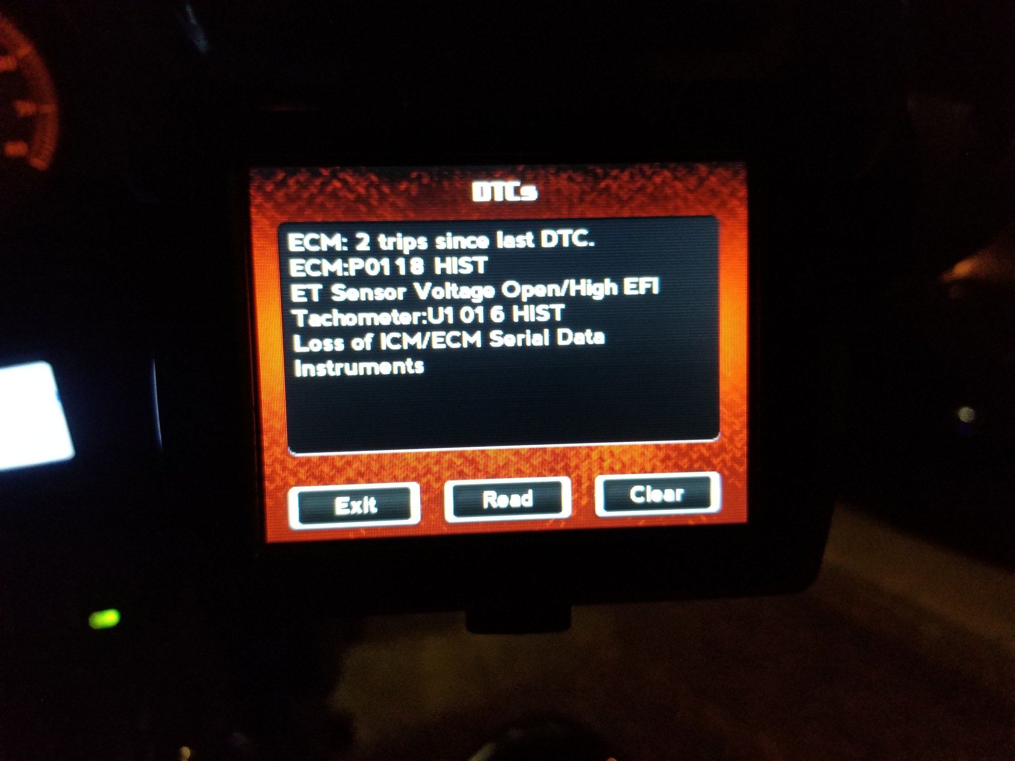

Originally Posted by Ed Ramberger
his code is ET. You had IAT
thanks for the correction. don't want to confuse but wanted to share my issues and fix. replaced the wires and plug on temp sensor and induction module.
havent had another code since replacing the wires and the plugs over 3000 miles ago
