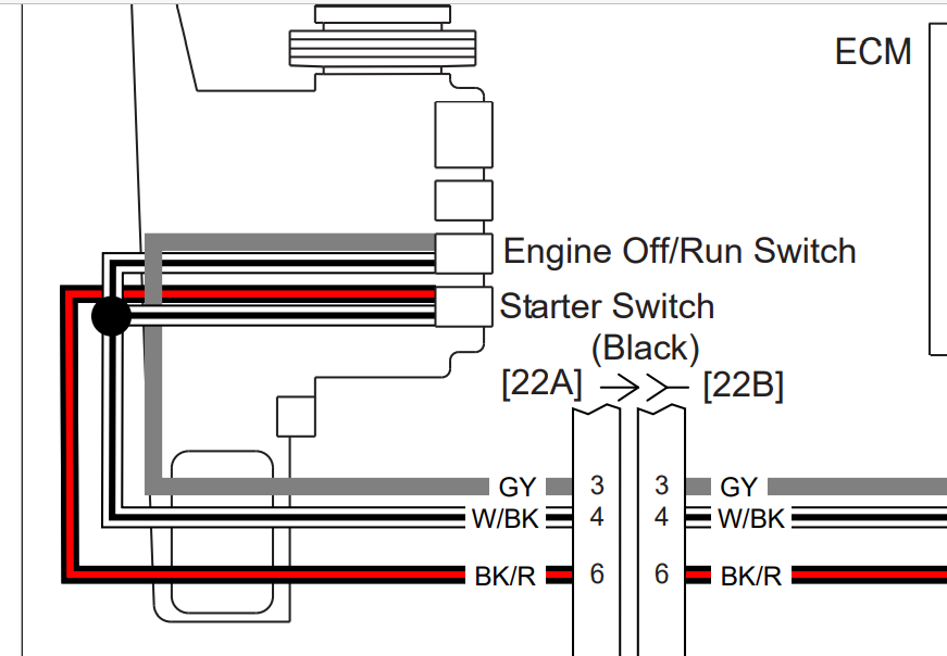

Here is my problem. I ride a 2008 RKC. My problem is while I was out riding, I started to hear my starter motor intermittently attempt to engage while the bike is running. I thought maybe the start switch wires were being pinched in the right handlebar housing. I took the switch assembly out and found nothing apparently wrong. Now the bike immediately starts as soon as I turn the run button to on and I never hit the actual start switch. This is a intermittent electrical issue and I cannot ride the bike in this condition. Has anybody in here ever had this same problem and how do I fix this. I do have the right electrical manual for the bike and I cannot follow how this is happening.

The ignition fuse, GY wire, puts power to the On/Off switch, turn it on and the W/BK wire has power going to the start button. Through the start button it powers the BK/R wire to the start relay. If the relay was stuck your starter would run as soon as ignition was turned on. Pull the start relay and turn the kill switch to run and see if you have 12V on the BK/R wire at the relay socket.
Might try a little WD40 on the switch.
