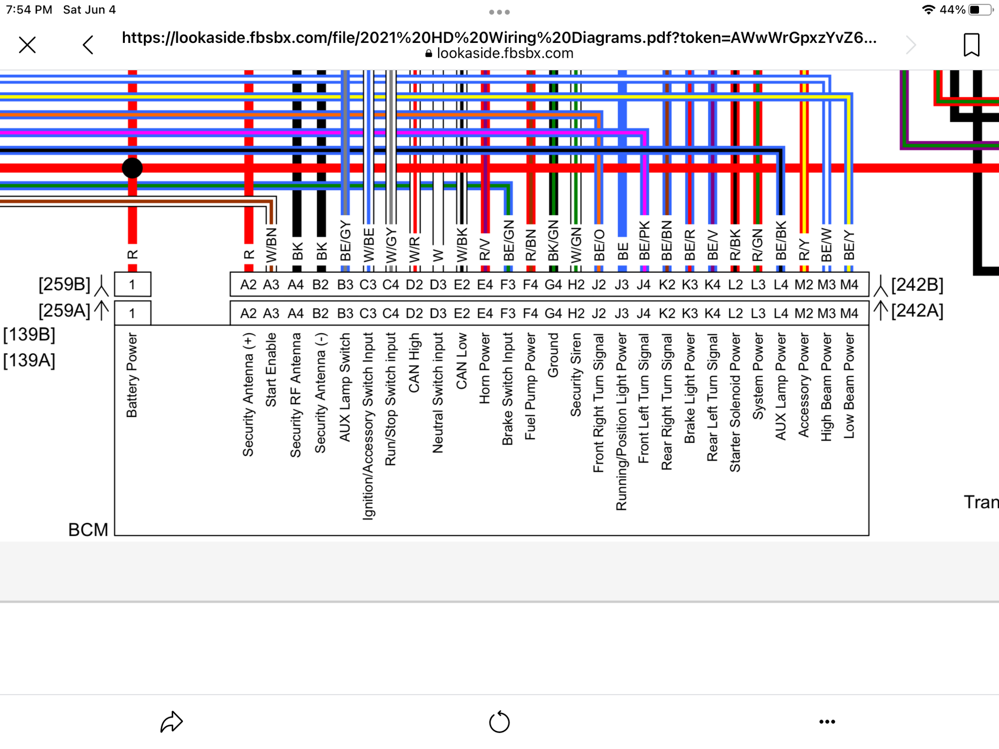

Hello all. I have a new pair of lower fairing lights and it is straight forward except the part where I need to connect the supplied harness into the yellow wire from the bike to make it all work in harmony. I have a 2020 Ultra limited with the I believe stock nice running lights. The issue is there is no relayed light to plug into or at least I cannot find it. And if I just plug everything in like a lot of YouTube pages say, either i get the lower lights working fine but with NO nice running lights or running lights and no lower lights... Very frustrating. I need to know where the relayed power comes from under the fairing. it seems as the white lights are hooked up someplace elsewhere??? directions were very vague.. Sorry in advance if I Was too vague as well. If anyone else has the running lights and signal lights and has installed these..please help a guy out

All the bikes lights are controlled by the BCM. Running lights are a Blue wire.

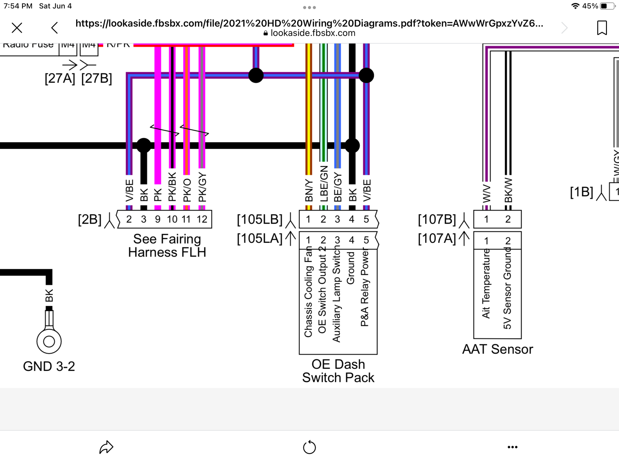

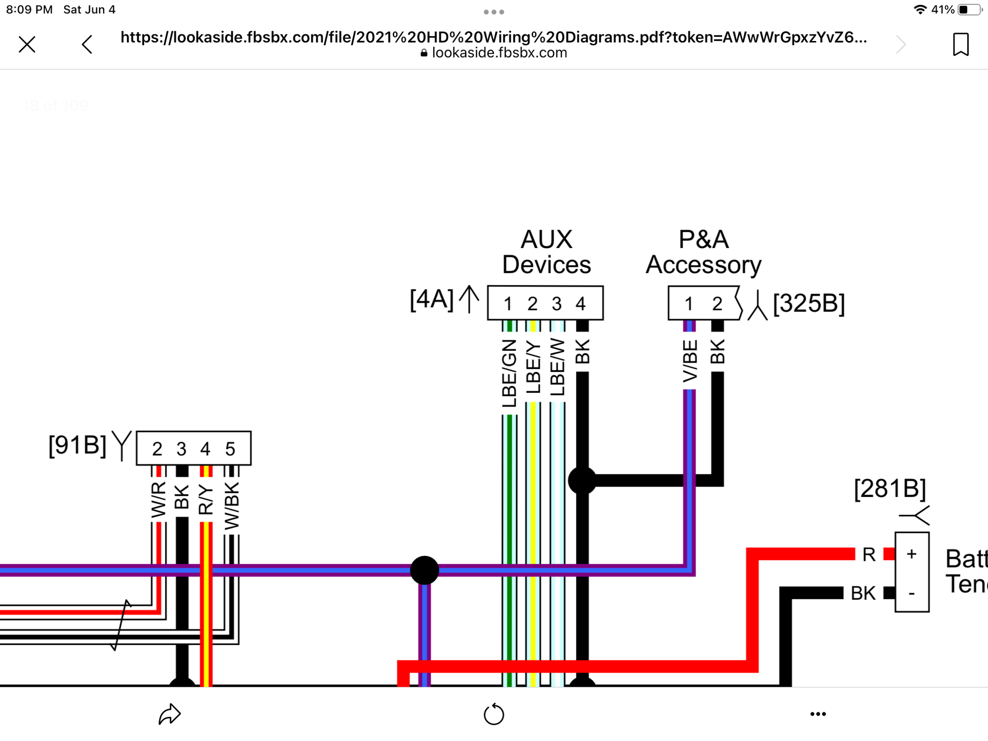

You might want to look into buying a harness so you can use the OE switch pack output 2 via the Aux Devices connector 4 LBE/GN wire.
