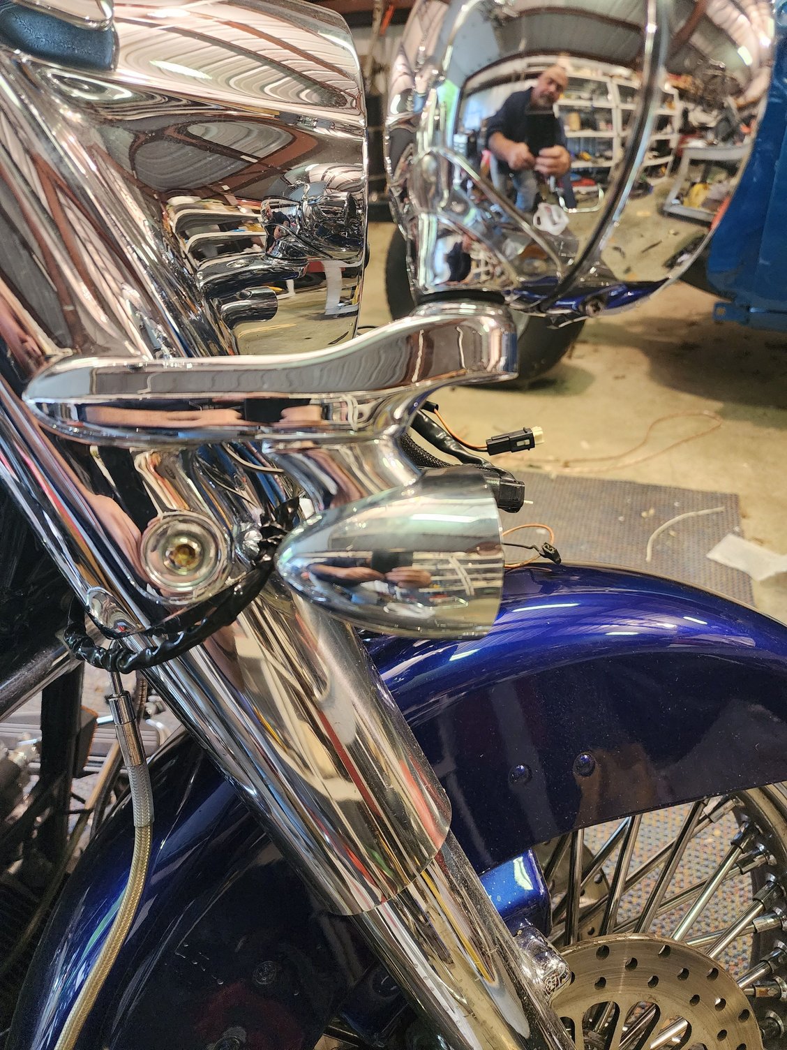

I installed turn signal led bulbs on my 2007 road king and they rapid flashed so I bought a badlands load equalizer and now when I hit the left turn signal the right front flashes with the left rear. Hit the right turn and both right flash correctly. I tried new bulbs, I took apart the signals and checked for shorts and cleaned the ground wires, replaced the cube flasher under the seat and checked the six pin connector behind the headlight and it seems to operate there fine... im thinking it has to be in the signal itself? Anyone have a set of chrome auxiliary bracket turn signals since I can't seem to find them anywhere

Is the equalizer plug and play?
I think you need to touch base with Badlands.

yes, plug and play
