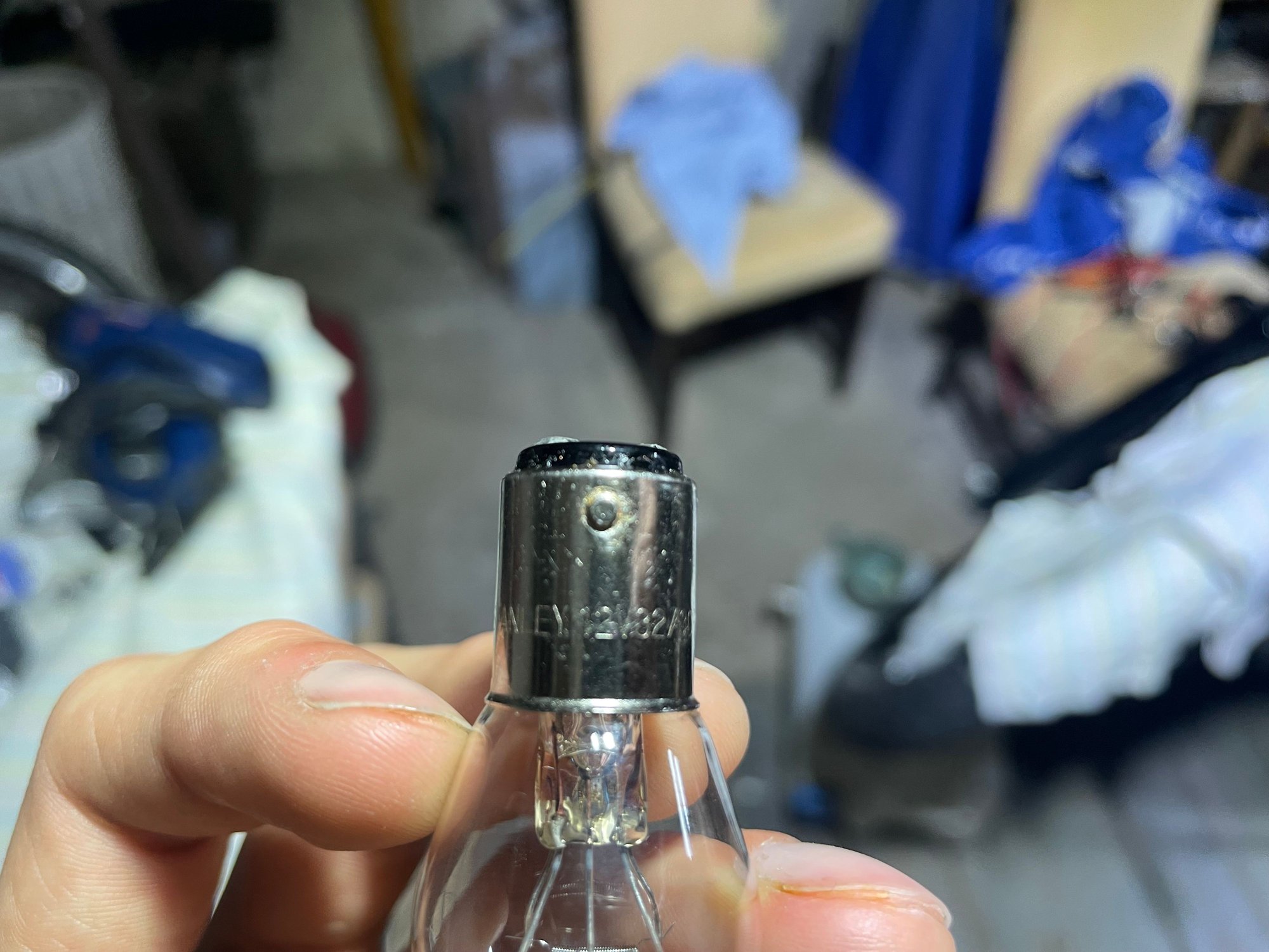

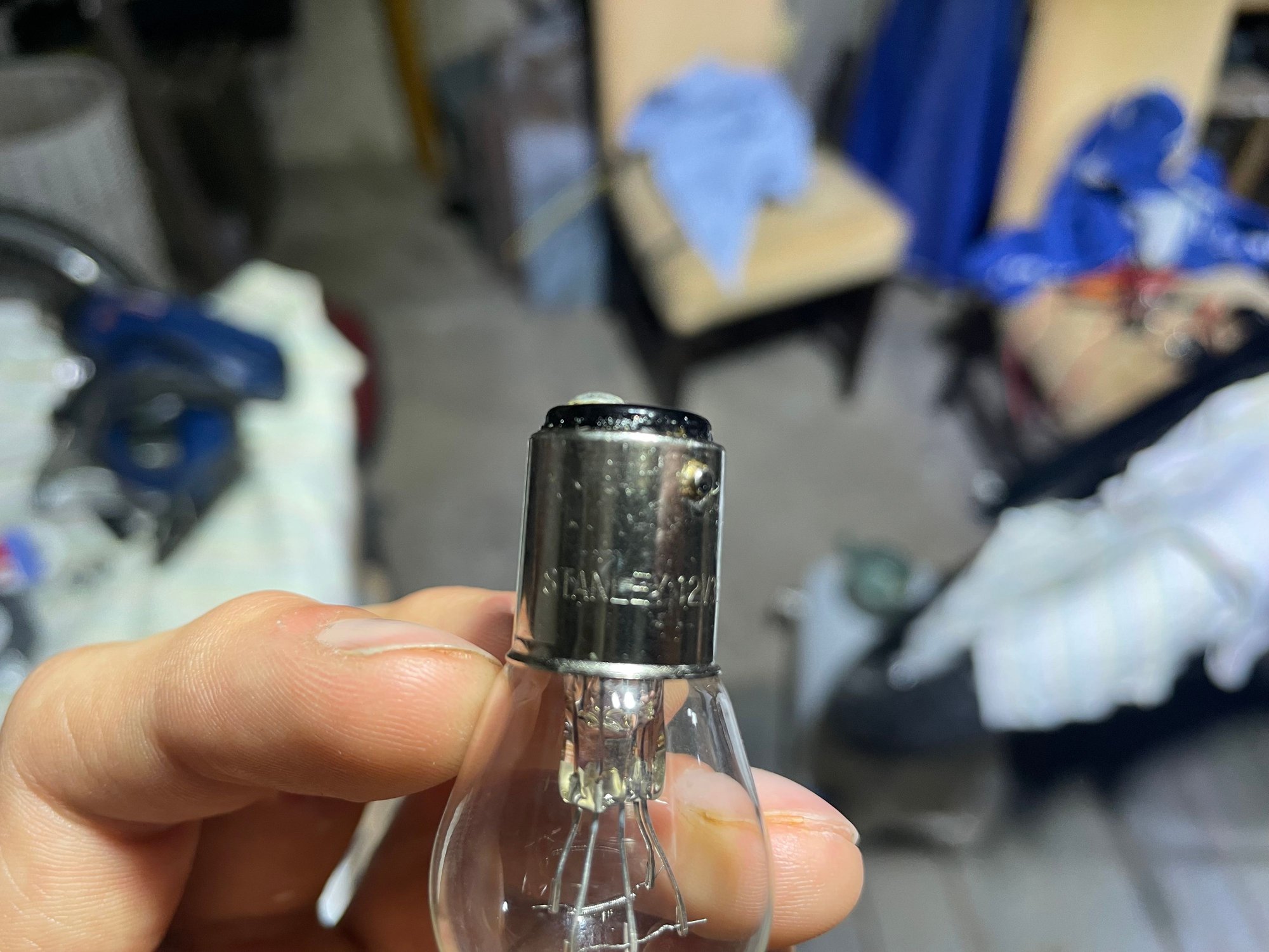

Front left and right: 32/3W dual filament

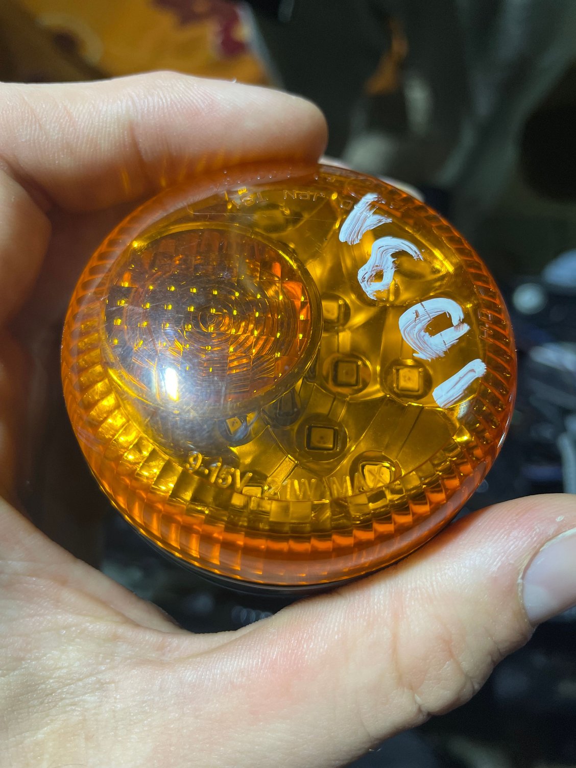

Rear left and right: 9-15V, 21W Max 3in1 Harley Led
After crash I changed front bulbs to 21/5W and changed rear left 3in1 blinker to a new one.
Old front bulb

Now situation looks like this: when I hit right switch the blinker goes at normal rate. I can do it as many times as I want and it goes normal rate. But as soon as I use left one (which works as it should) even once, the right one goes crazy after 3 blinks and starts blinking rapidly.
The only thing I can do to reset it is pull out the battery and then plug it back. Then it goes the same as stated above.
Also when I unplug any of left blinkers (front or rear) the right one works fine, no matter of left usage. When both blinkers work simultaneously their rate is proper.
I’ve tried to change bulbs on sides, unplugging each of blinkers and resetting battery, looked for shorts on a wires (removed covers, pulled them out of handlebars).
I am starting to lose my mind, any help would be appreciated. Thanks in advance!

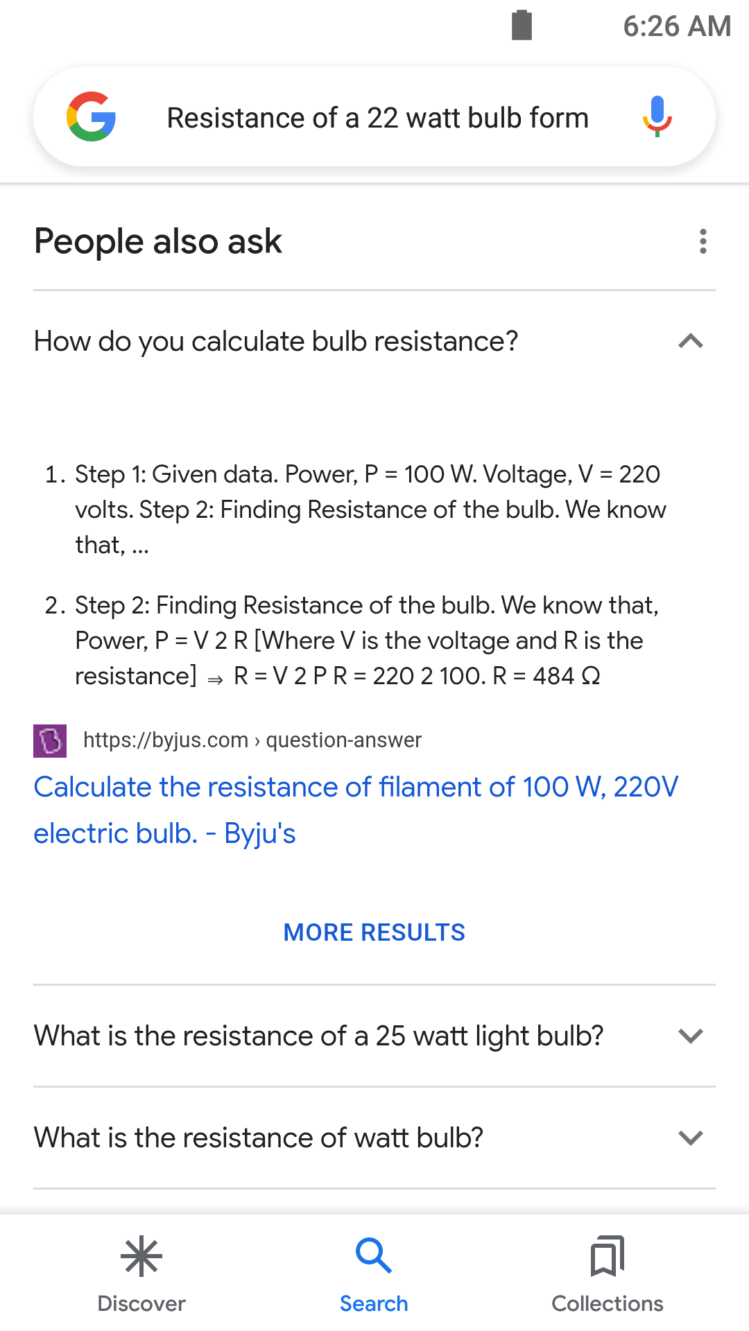

Not 100% sure even which way resistance went with original to your new bulb.
Your asking the wrong person what that change did. From what you said , what has happened, that to me would say it's the cause.
I'm still wondering why you said what you did in first post and then said you didn't change anything.
I would put the same rating bulbs in. I have seen non OEM LED tail lights not work with new systems with the BCM. Are you sure the rear LED is exactly the same part number as the old? Does it have a built in resistor or one been added so it worked with your old bike.
If you must run the front different, you need to check resistance of what worked and compare it to the new and put proper resistance in.

SOLUTION
I've done some checking and it turned out that when I connected the old (one I've got before the crash) 3 in 1 blinker on the rear, problem disappeared. I think that either the guy who told me that the rear blinker he is seling me is original tricked me, or the blinker is indeed original but from another model or something and the ECM goes crazy since the resistances on both sides are diferent. Anyways, need to buy another rear led (and now make sure it matches) or instal resistors on both sides.
