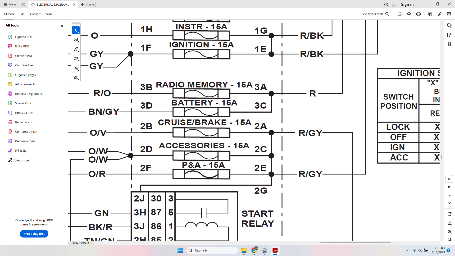

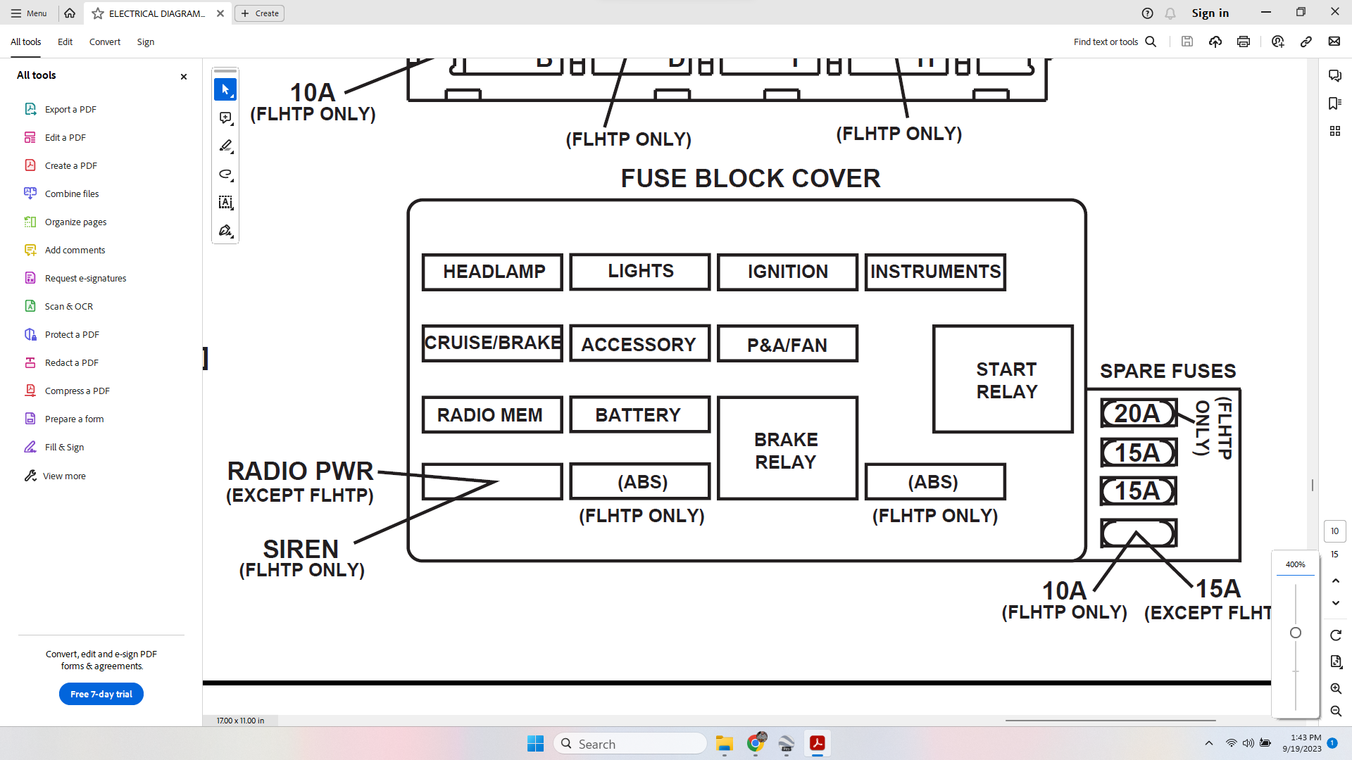

Hey @MURPHCC1 ,
I know I'm asking a lot of questions, but i promise it is to help get to the root cause of the issue.
Is your bike or has your bike ever been lowered?
I ask because many times the rear harness gets burned through by the rear tire and it goes totally unnoticed until there is some sort of unexplained failure with the rear lights and/or fuses.
Just trying to eliminate possible causes.
I'm also confused about your issue because it isn't clear which fuse blows...
According to the manual, fuse #3 is for lighting (15A) & fuse #5 is for brakes (15A)
Maybe you've already specified which one is giving you trouble, but my thick head isn't following the story very well and with just a single fuse blowing, you should not lose your brake lights AND your other lights (turns and running lights).

Originally Posted by RANGER73
The ONE fuse that is blowing has the DIRECTIONALS (in my verbiage, BLINKAHS), the CRUISE and the BRAKE lights on it.
OKAY, so what are you using when the fuse blows?
Slowing down?
Using the cruise?
Using the Blinkahs?
You're in the Cape which is part of Mass.
And no one uses Blinkahs in Mass.[/QUOTE]
I dont know exactly when it blew, I was on the highway about 70 miles from home heading to Texas. Taking a turn and I USED MY BLINKAHS, but they weren't showing that they worked on the dash, so pulled over into a gas station and checked it out.
Old Sep 19, 2023 | 01:47 PM
MURPHCC1's Avatar
MURPHCC1
Joined: Apr 2013
Posts: 5,812
Likes: 3,810
From: Cape Cod
Fuse #2B-A.
I have used the lowered shocks from PROGRESSIVE in the past.
Gonna have to give it a good when I get back sometime in Dec-Jan.
THANKS to all for the help!!!
Murph
