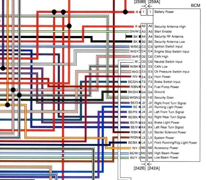

They won't turn on unless the "ACC" wire is attached. My understanding is this is a wire that needs attached to something that is "keyed" so the lights turn off with the bike.
In my headlight bucket I found a wire tapped to the harness. It is blue with a black stripe with a female connector and is capped.
Does anyone know what this wire is used for?

@benny.d Welcome to the forum from Utah!
That's the Front Running / fog light power from the BCM, should be what you hook the yellow wire to.

@Vernal Thank you so much for the wiring schematic. I really appreciate the help!
