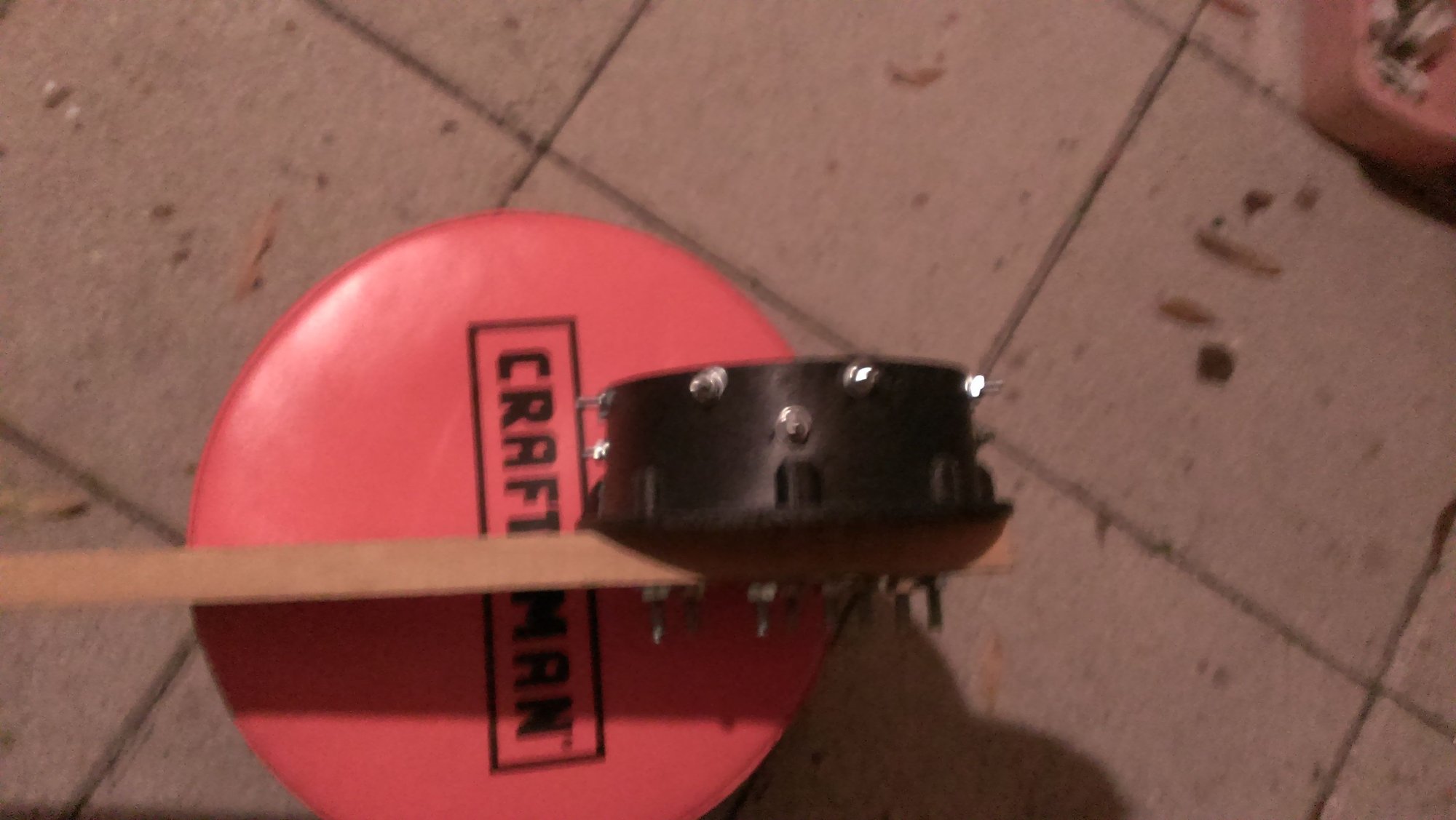

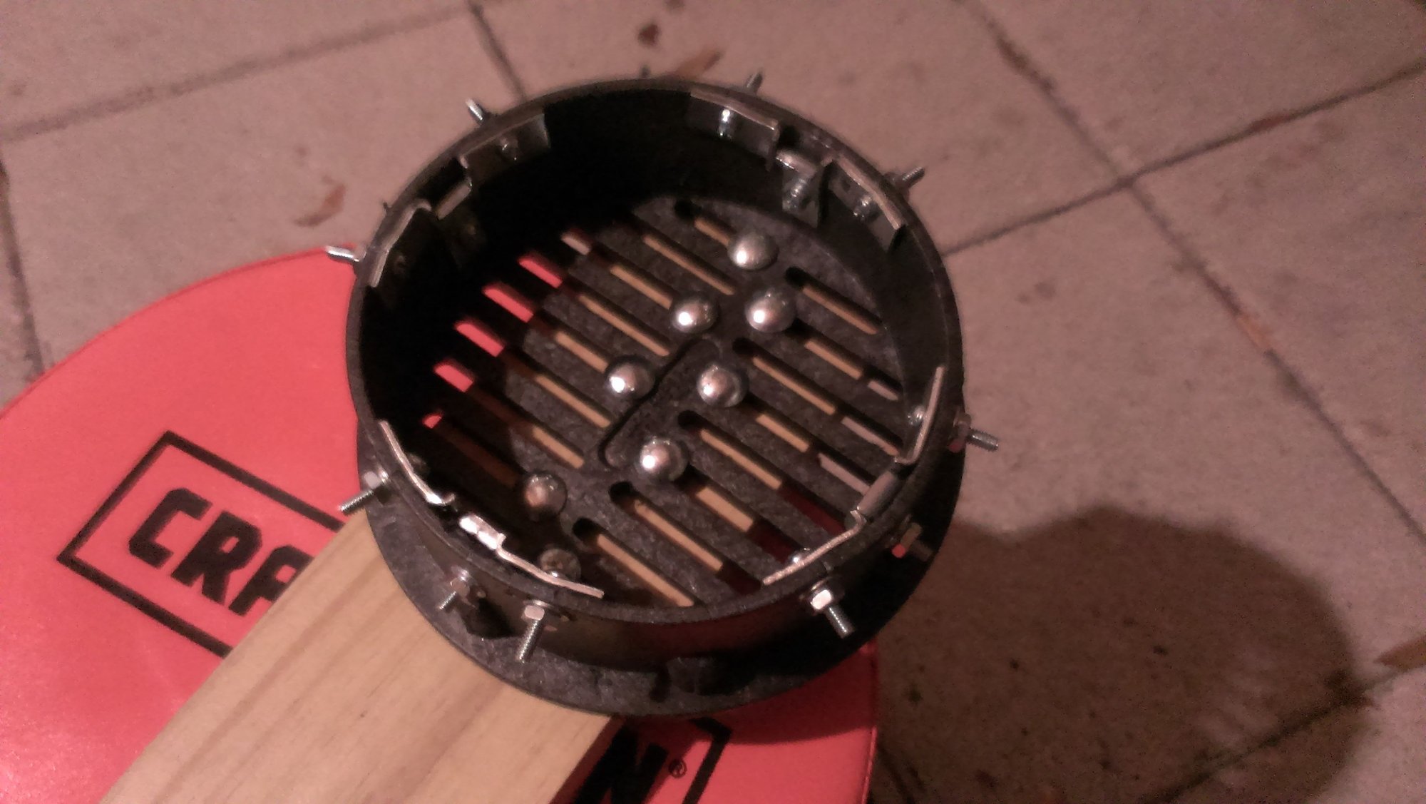

Well, Here's the rest of the story. 5" PVC slip joints are a special order, Not one plumbing supply Co had one in stock.So I modified a 6" grate inlet (fits inside 6" pipe) with a dozen angle brackets with one side cut down to 1/4" bolted inside to form a tool with a 24" 1x4 bolted to the grate. Not very pretty but it worked. Pulled filter assembly and changed filer. Found the POS. Made my day, Too bad it rained all day.

A picture of what you made would go pretty well right about now don't you think?
Congratulations for figuring it out! You 'da man!!

OK, Since you asked, Don't be frightend lol, It's scary ugly in an Edward Scissor Hands meets Frankenstein kinda way. Seriously though, The grate was deep enough to clear the filler spout without the cap, And the ID just fit snug around the tabs on locking ring. Needed extra carriage bolts through grate so as not to break the slots( Not quite as rigid as PVC fittings) Also got lucky those ***** around the outside made getting a perfect X ,90 Deg. angle easy.
