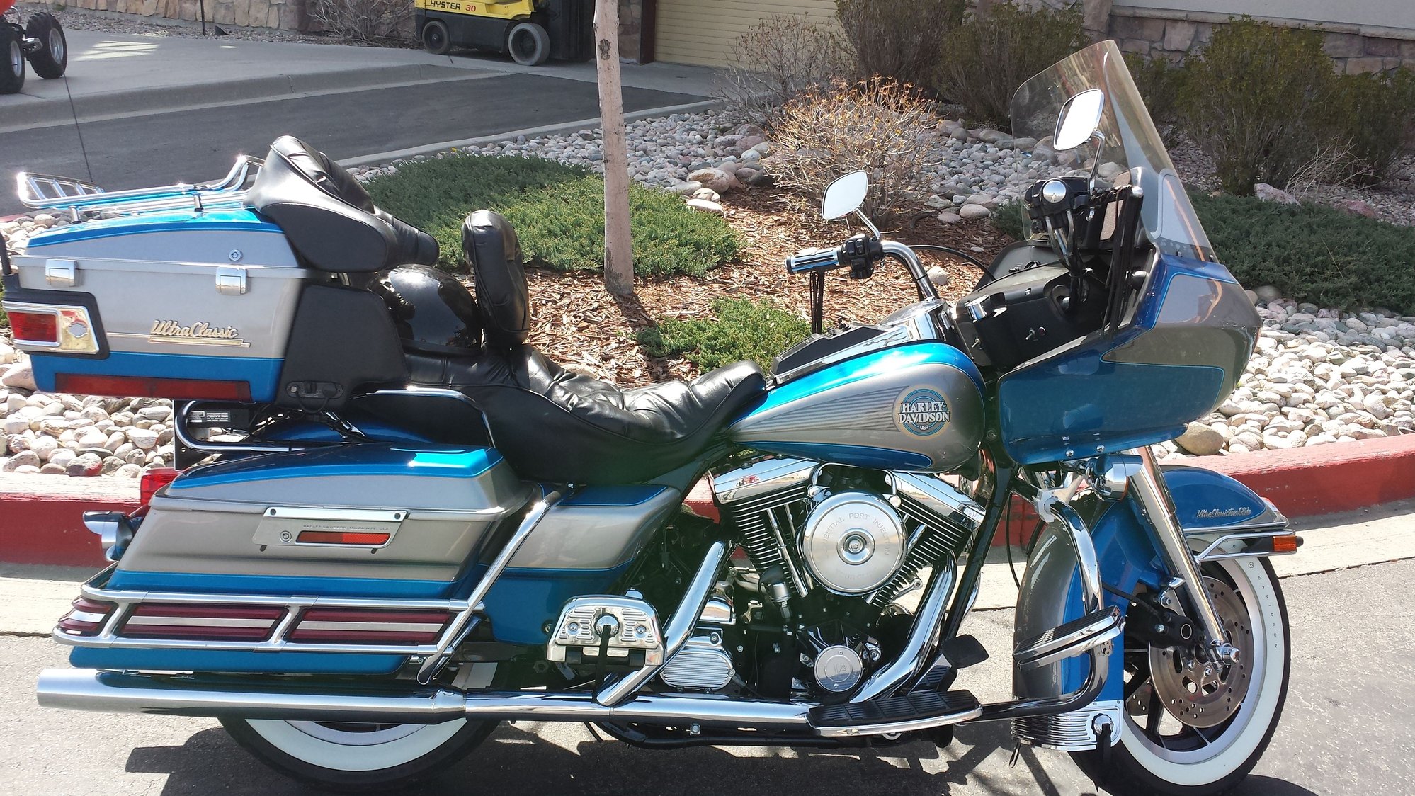

Here is the bike...... I LOVE this thing!

No, duration is good but a little bump in comp will take it to another level. you can always deck the head .020 or even just a .030 head gasket will pick it up ie: 9.0 to 9.2 but if ya got the heads of might as well deck em.
