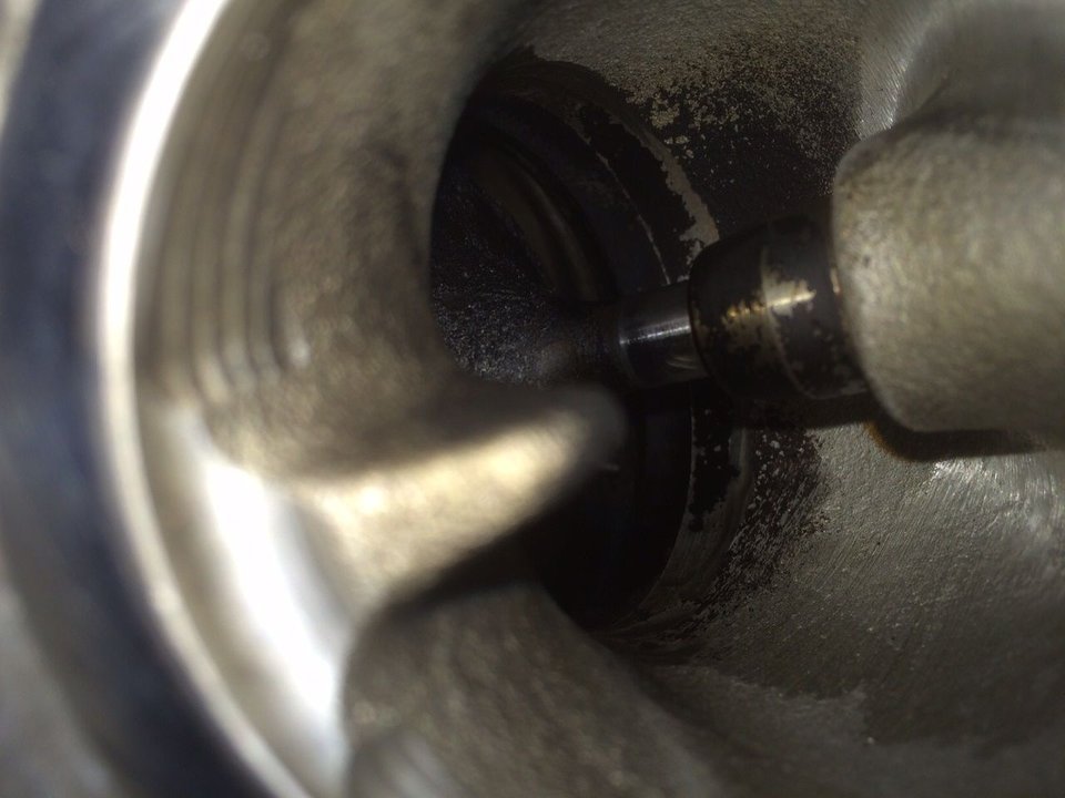

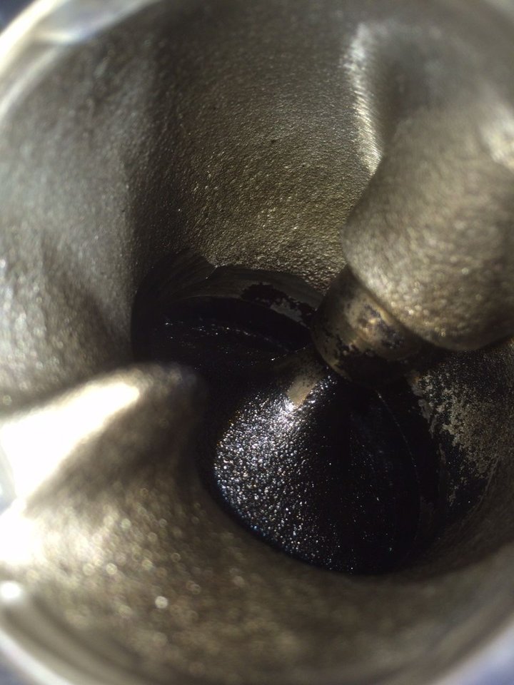

Also, I started tearing into the motor last night and noticed the intake valves looked pretty gummed up. I will attach some pictures to see what you guys think and if they would indicate another problem with the current setup.
As always, thanks for the time and input guys.

I continued on the tear down and inspection last night. All gaskets appeared intact down to the base gasket. My piston tops did appear pretty sooted up and I am wondering (before I start putting it back together) if they, along with the previously posted 'gummy' intake valves are indicating something is not quite right? Any insight?

Have your heads every been freshened up with new valves, guides, springs etc.?
Looks like possible leaking guides, and Pistons look they are exposing your possible oil control problem.
Is head work in your budget, and did the Pistons clean up nice?
That's exactly my thoughts, PW. Guides....
