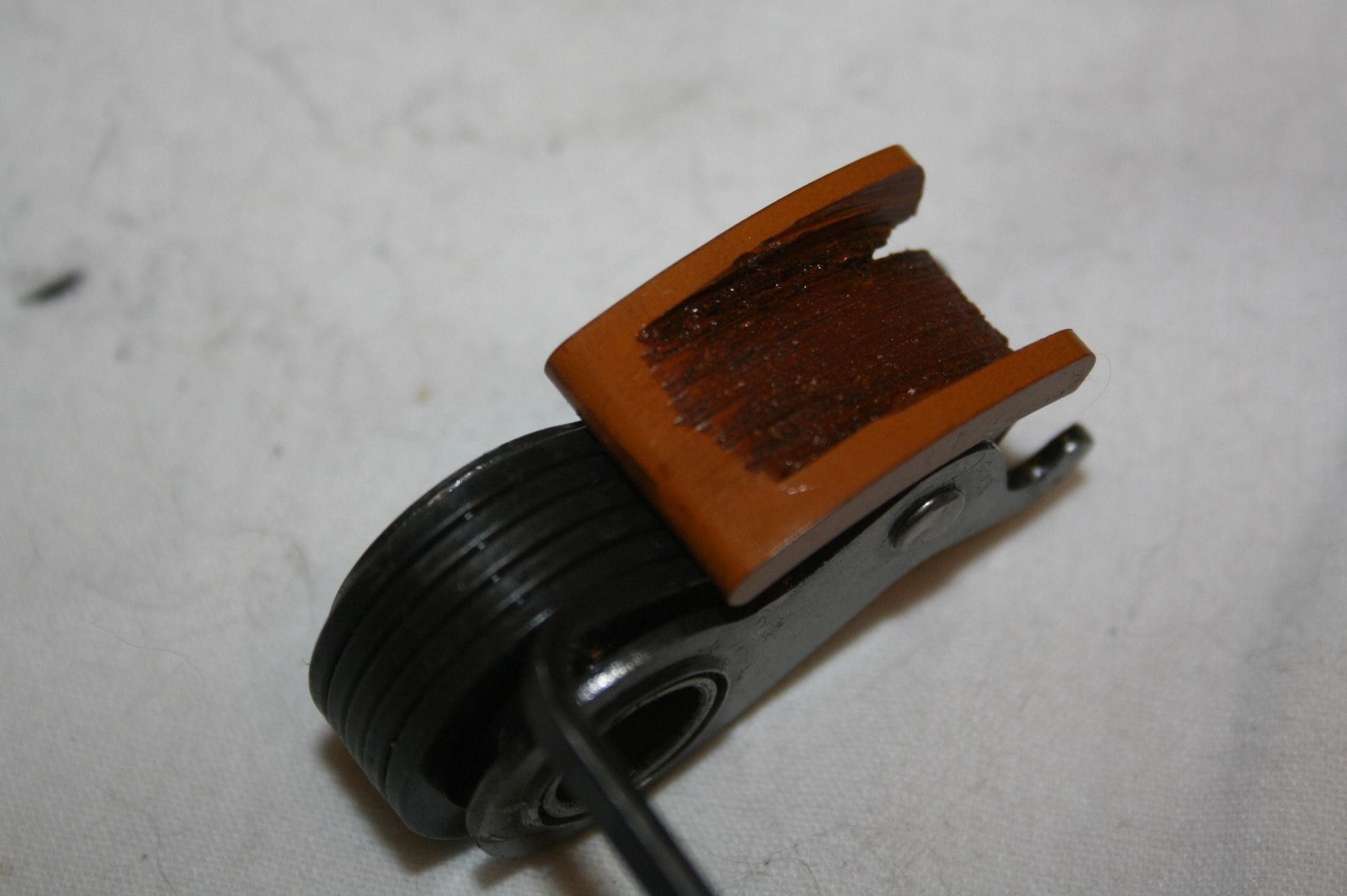

Did you have a reason to check tensioners, maybe chain noise? I would like to see worn out tensioners if possible.

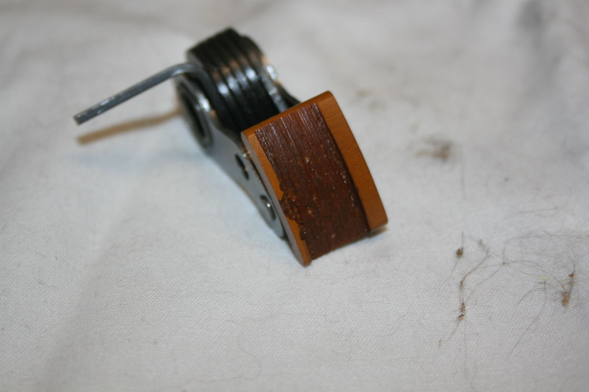

They were supposedly replaced by a local dealer at 33K miles and I just rolled over 61K miles. It was time to check them and it was time for an oil change and I wanted to clean up and polish the cam cover and install chrome hardware at the same time.
The outer one looks like it might have 28K miles on it, but I am not too sure the inner one has ever been replaced even though it was supposed to have been.
outer
this doesn't look like 28K miles...
