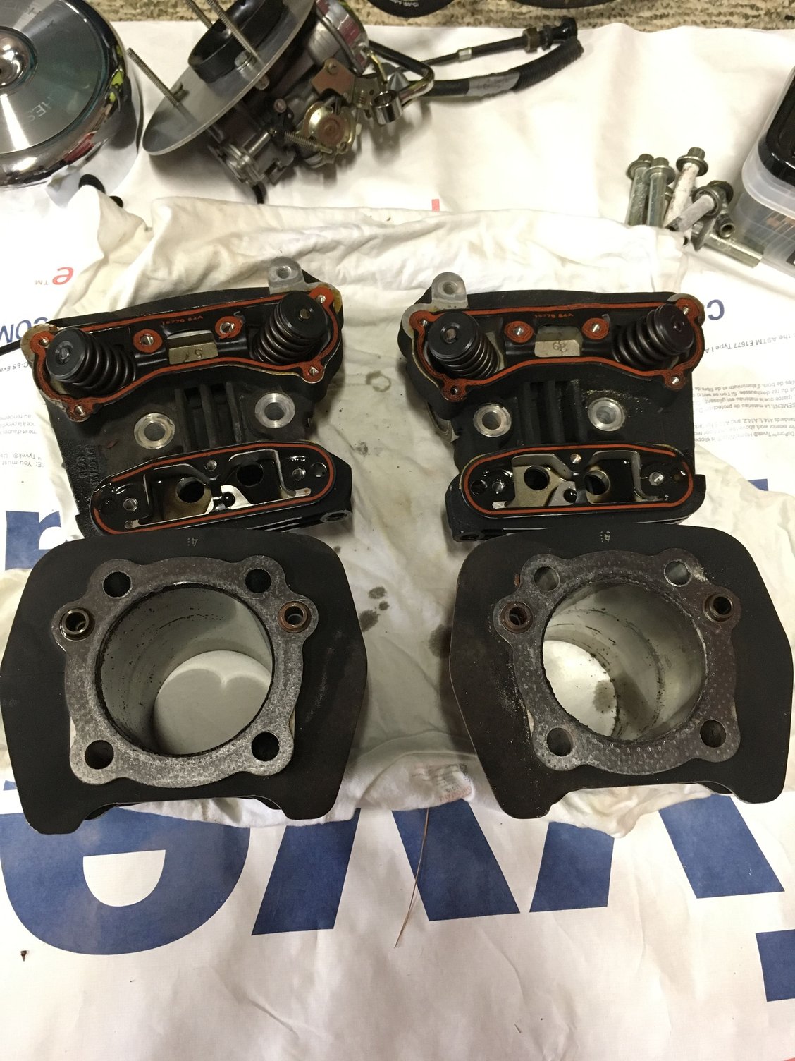

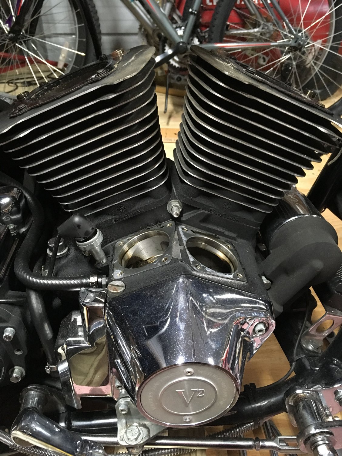

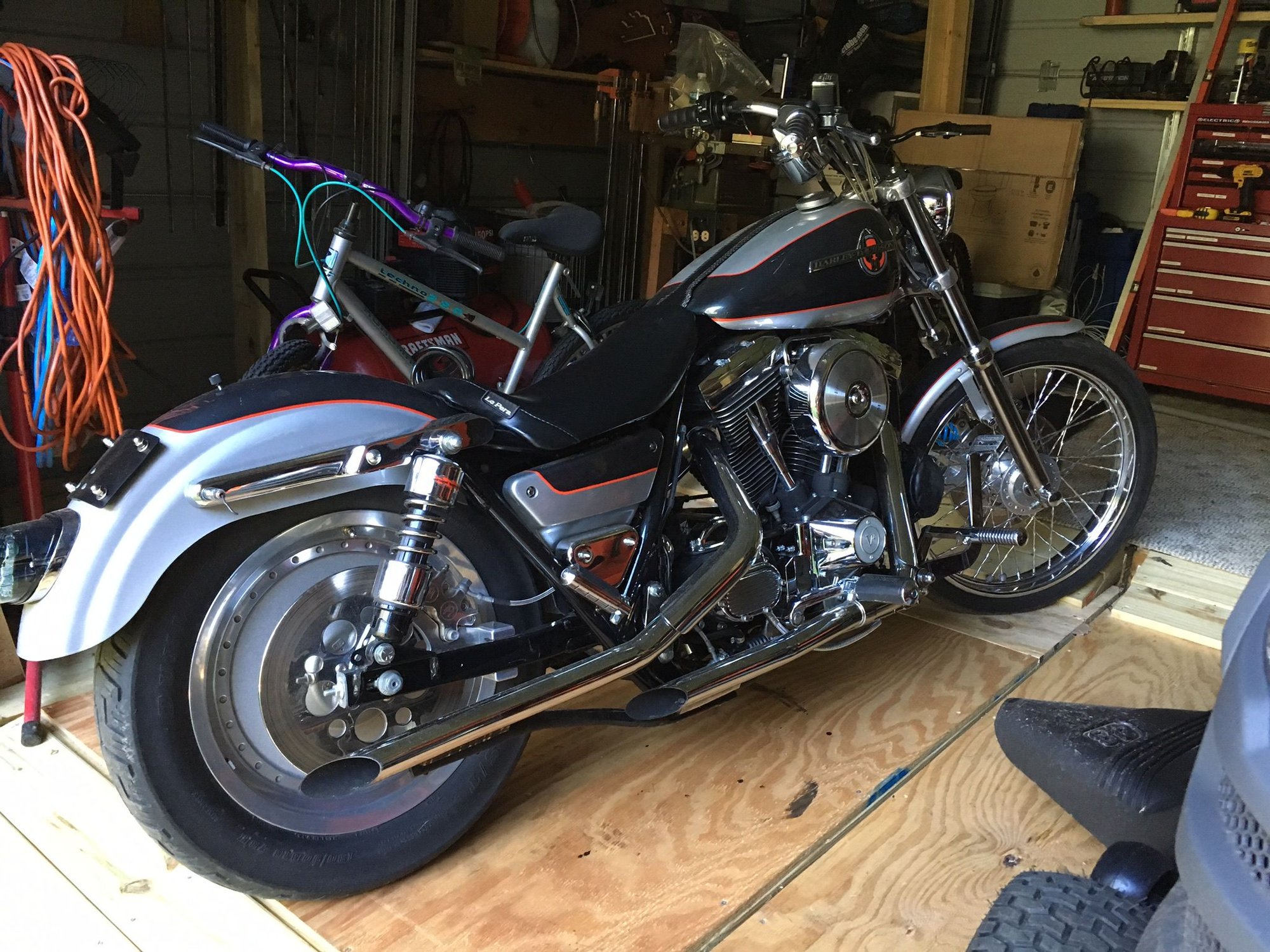

Finally decided to build up my 80” fxlr. Went back and forth on small things so just took the plunge. Just got the heads and cylinders off this morning thanks to a hiccup from the frame mounted key ignition. Got that out of the way now back on track.
My plans are staying at 80” and going to 10.7/10.8:1, dual port heads worked by Sams in Charleston SC, port matched manifold, Woods W6HF cam, Woods lifters, mik48 carb, adj rods, baisley rockers, Daytona ignition, Woods 325 filter and RB Racing LSR 2-1 turnout. Maybe some Velcro if strap to keep my 165 lb *** on the bike once tuned.
Wanted to hear from anyone on yays and Mays of the build. Or general input. Pretty pumped to hear the heavy idle this summer finally.
Preciate it. See ya.
