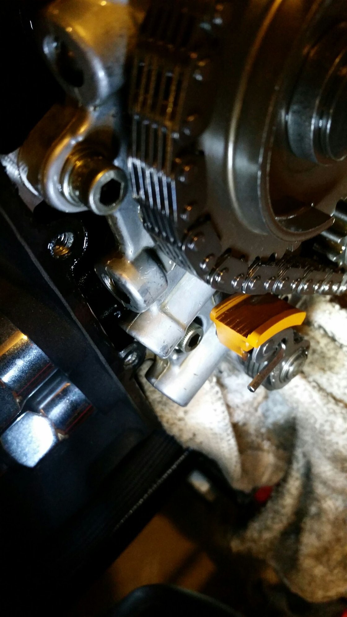

Yea long over due. Never heard one noise out of it. Good thing by next week Scott at hillside cycle is getting it for the 98" build.

How many miles on those tensioner blocks?

30,000 miles on mine

Wow! A little late on the inner, but just in time for the outer. Was there any "flotsam" in the chain case? Oil pump damage?

oil pump looks real good yet. no scoring

I saw those the other day when they arrived.
You wouldn't have wanted to go much farther with those.....lol!
New Cyco shoes, and a .200" pressure shim, will have you in good order.
