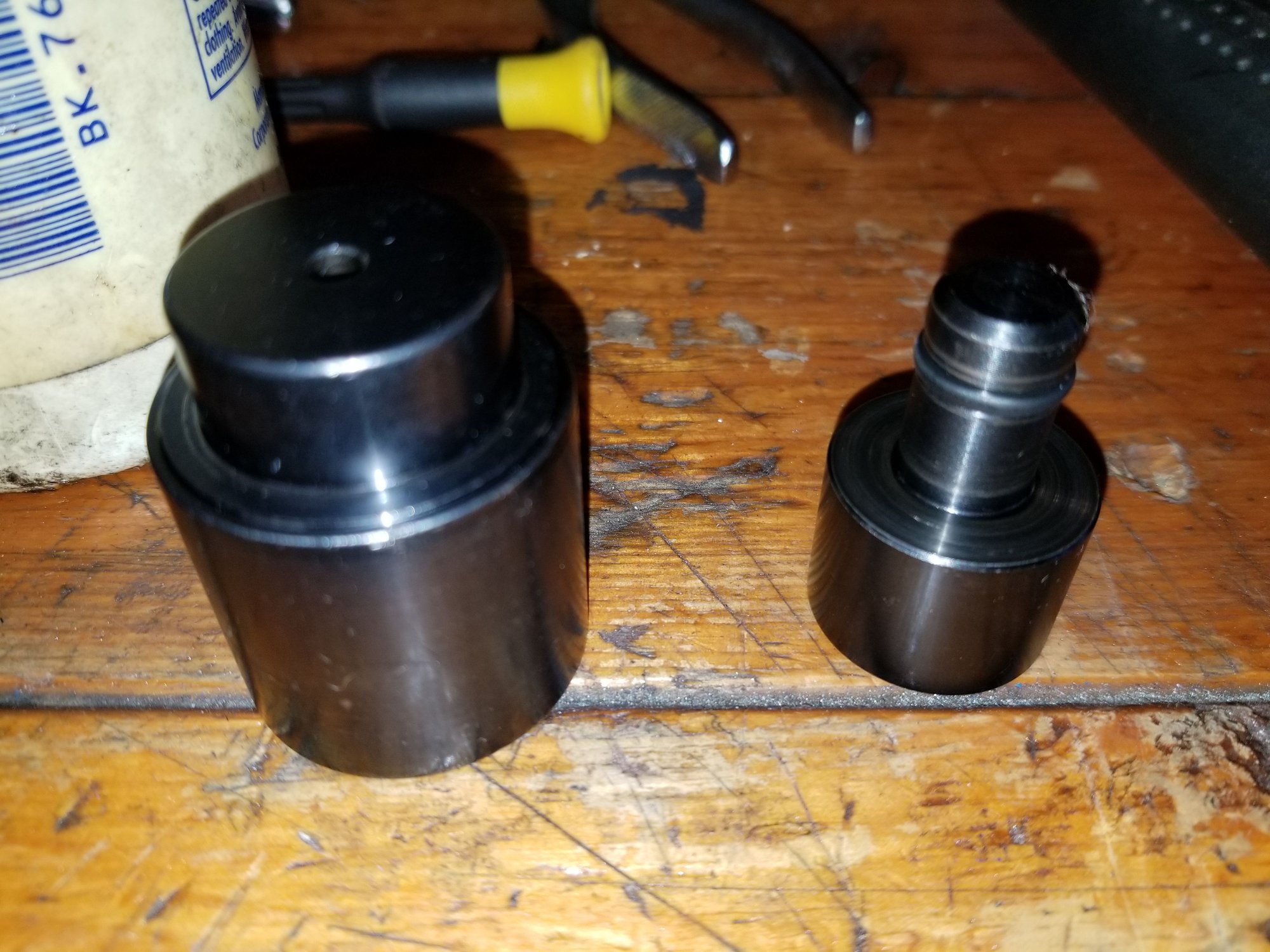

  #34
Okiemech's Avatar
Okiemech
Joined: Mar 2018
Posts: 22
From: Okc
This was the last bike I used the tool on. Bearings are perfectly set .020 deep. No damage, nothing.

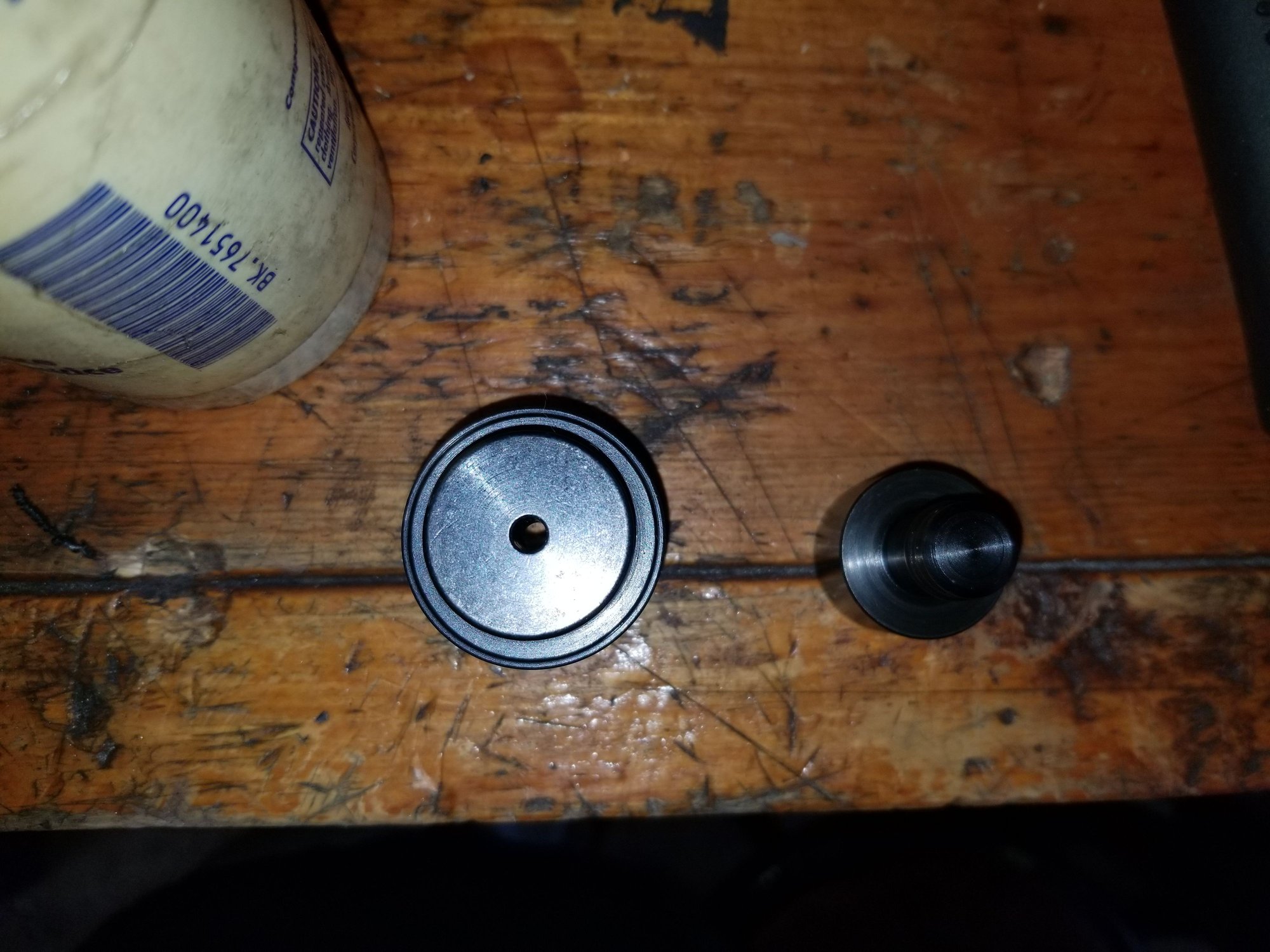

Old Apr 5, 2018 | 07:08 PM
  #35
Okiemech's Avatar
Okiemech
Joined: Mar 2018
Posts: 22
From: Okc

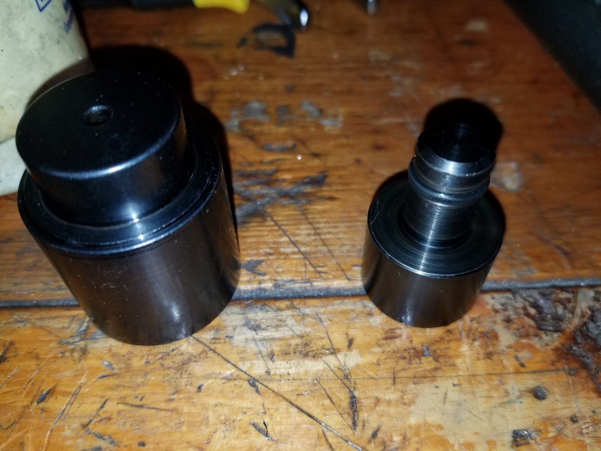

Old Apr 5, 2018 | 07:09 PM
  #36
Okiemech's Avatar
Okiemech
Joined: Mar 2018
Posts: 22
From: Okc
Old Apr 6, 2018 | 07:13 AM
  #37
Ed Ramberger's Avatar
Ed Ramberger
Joined: May 2015
Posts: 3,584
Likes: 1,213
From: Then Wisconsin, now North Carolina
I think I've posted at least three times about verifying the bearings because the first pictures looked like no-namers - others have also suggested bearings.
The pictures you just posted appear to have different bearings than the ones that failed. They are Koyo in the ones that didn't fail.
So, my thoughts are still the same. I highly doubt they were pushed all the way in crooked or the tool is to blame - especially if it has been used successfully before and since the failures.
We have already covered depth and making sure the rollers roll.
So I'll ask again - please let us know who the bearing manufacturer was of the failed bearings.

Old Apr 6, 2018 | 09:25 AM
  #39
Ed Ramberger
Joined: May 2015
Posts: 3,584
Likes: 1,213
Okie, Here's where I land with it. Personally, I don't think you installed them incorrectly. I'm not 100% with all the bearing makers, and typically will go to a bearing house to really get the best info on manufacturer and quality info. I have never had a failure like that, but I have only used Torrington, Koyo (I believe they bought Torrington) and Ina manufactured bearings.
From looking at your pictures of the installs and the tools, my suspicion is the bearings were the problem. However, in the one where you installed new bearings on a 50K OE cam, I would not recommend doing that as it opens the door to a failure after the two materials were run together for so long. If you had only posted that failure, I would most likely be saying I believed that was the cause, but you also have a brand new cam with the same failure.
That's just one guy's view from what he can see from here.
