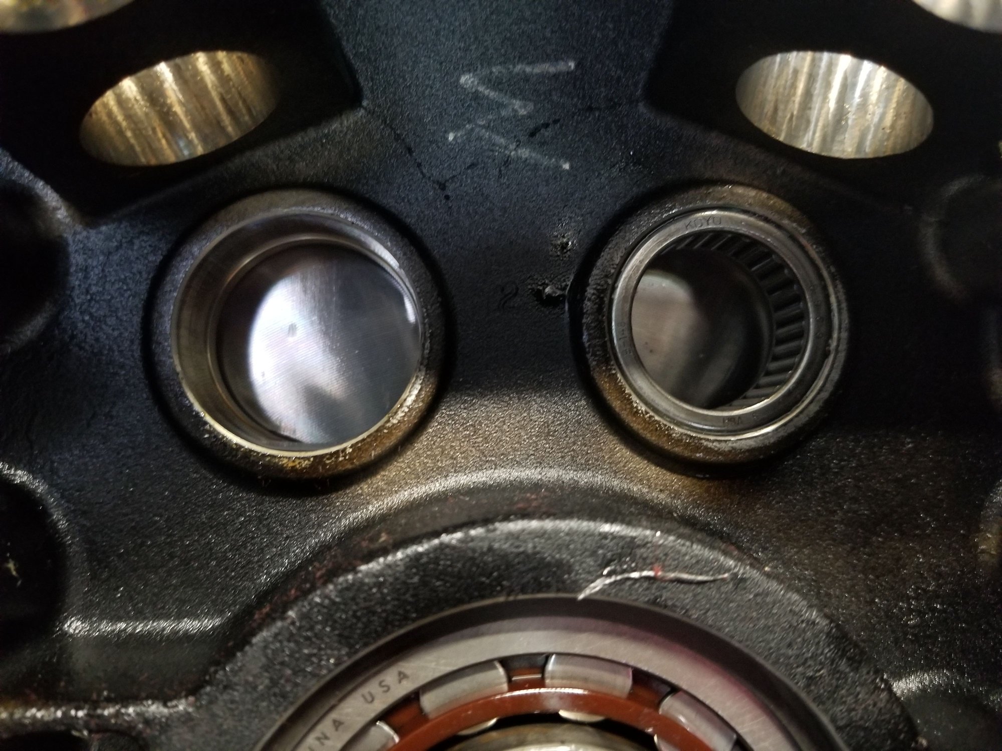

Just recently built the motor on my 2001 fxdx with a tc88. Went to 98ci, ported heads, forged cp pistons, cams, bla bla bla. Made 98hp/115tq.
Since the build i have put about 1400 miles on the bike. I was going over some pictures from when i was assembling the motor, and saw what appears to be cracks in the case near the cam bearings.
How bad does this look? I've never built one of these motors, and don't know how I missed it when it was apart. Something to be freaked out about? Because it's making me nervous!

Casting flash- not an issue.

just to be clear, I'm talking about the circled part

Yep- I've seen that quite a few times over the years. None of them were actual cracks. I split the cases, and remove the bearings on the first one, so I could sand it down for welding- once sanded, the "crack" dissapeared-
Thanks for the info! 👍
