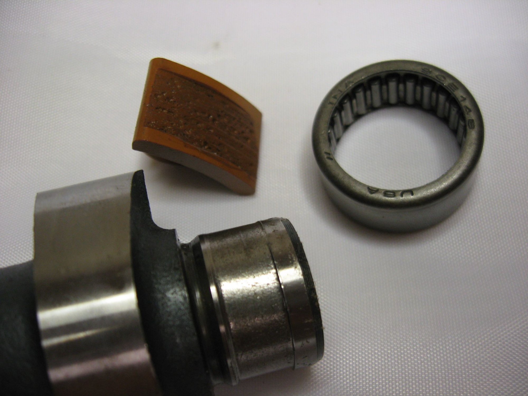

The youtube squeak stops with rpm increases and engine isn't shaking.
Had a squeak similar to that. It was cam bearings skating (wearing) on the cam.
My squeak from INA bearing. Yeah, I know, crazy. That what it was. B-148 and S&S 509 fixed me right up.

Should say it was simple, but wasn't. Couldn't find anything around frame, under gas tank, exhaust or anywhere outside. So... had to be something inside. Lot of moving parts in cam and rocker areas.
