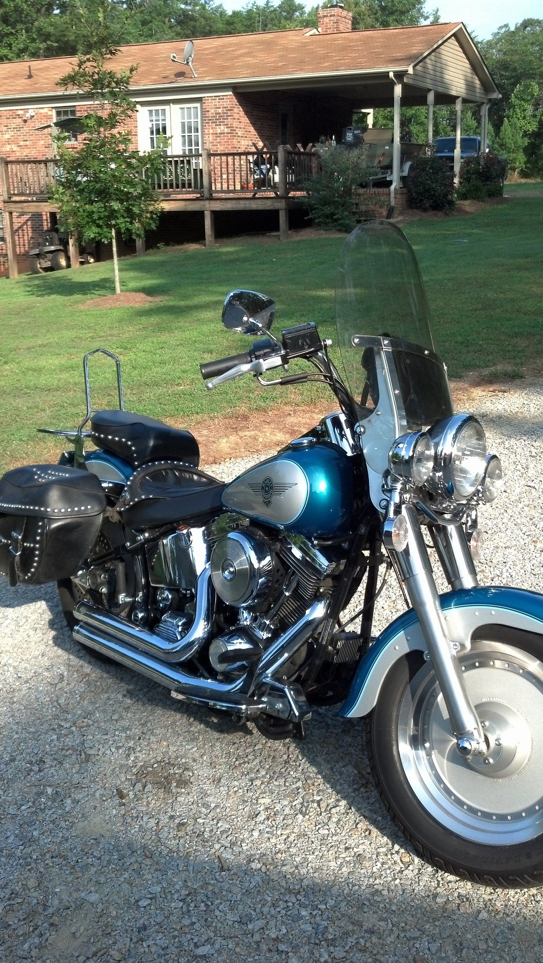

I have a 95 fatboy not riding much since I bought a 15 ultra. What should I do for storage?
