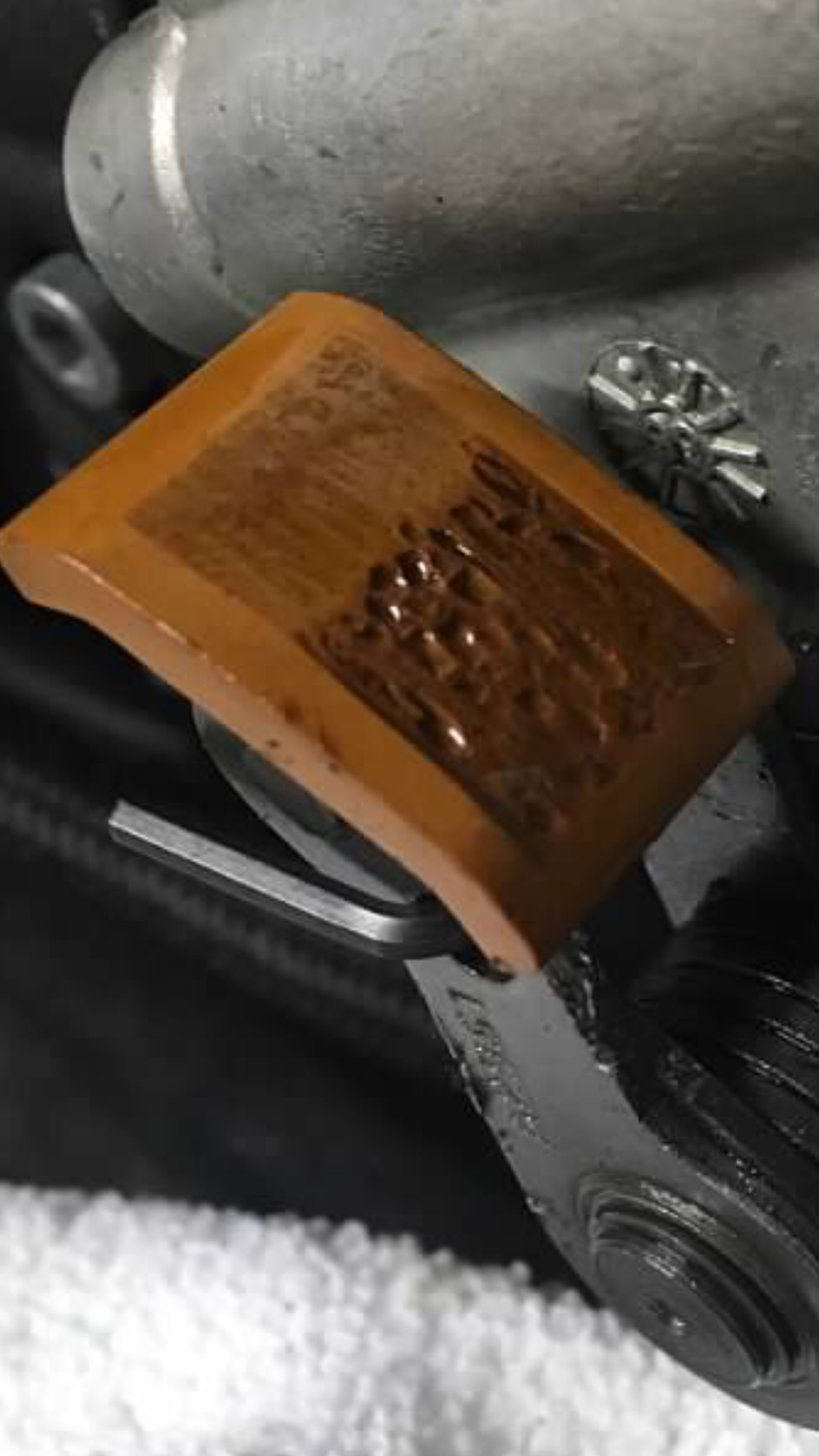

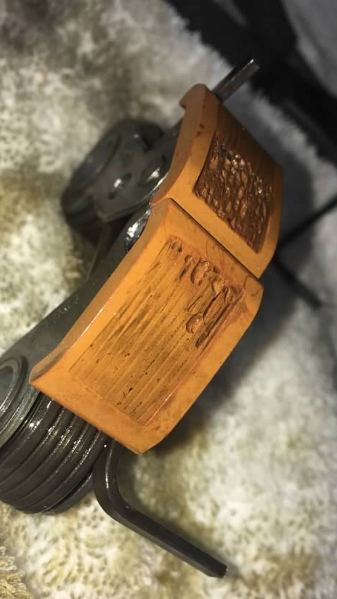

For out outside pad, I used a large pair of channel locks wrapped to protect the metal from marring. For the inside I used a screwdriver to lift it just enough to see in there with a dental mirror and light (which hardly showed anything and left me wondering).
How much wear? This one is funny to me because look at these pics. The pads looked great until you peeled them back and see that the overall wear was just fine but there were big chunks missing from the pads. And guess where I found them? Oil pump. Had to replace it all. Went with gear drive S&S.
As far as the exhaust gasket, Re-using them will likely cause an exhaust leak which can lead to broken stud bolts when you think you just need to keep tightening it, just get new ones, they're cheap.
Outer pad "Looks great"
Outer pad pulled all the way back. Those missing chunks are a problem.
Both pads once I gutted the cam chest. Those chunks scored the oil pump and were also found in the cam chest.
