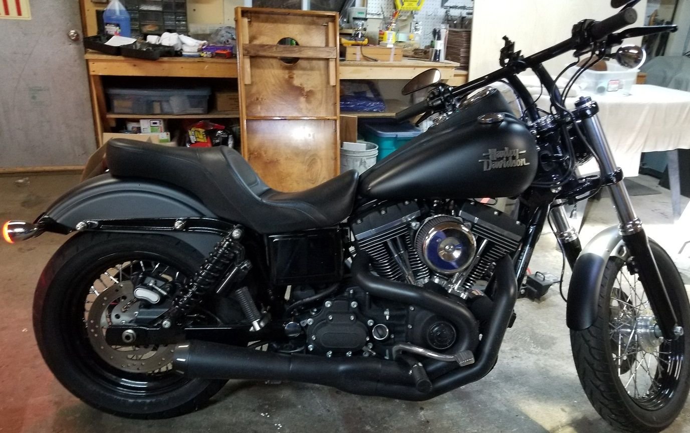

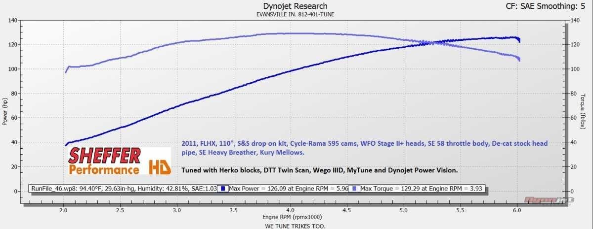

This was a 103" to 110" Stage 4 build and tune. Work done by Sheffer Performance in Indiana. CR machined heads, Bassani RR2 Short pipe (impacted my low end a little but still love the look). HPI 58 TB with larger injectors. Quite the change from my Stage 1 upgrades! Needless to say I'm pleased.
For those with bigger bikes and longer pipes, I've seen dyno charts of this build with another 10+ ft-lbs of torque 2000-3000 erpm with no appreciable fall off on the RH side.

Nice Tune.That's the only Cyclerama cam that I don't like. Its really sucks on the bottom of the torque curve.

Actually, I think it's really more the effect of short pipe than the cam. I already had the RR2 for tall shocks which is really short and doesn't tune well down low with this cam. I spent the money on the build knowing I could go to an exhaust more fitted for the build in the future.
I have charts of this same build, full length pipe like a Boarzilla or Mellow with the CR595 making 100@2000 and 110@2500. I just didn't have the $'s left to go for a new pipe at this time.

Looks pretty damn good to me. I have a dyna too, very fun. Nice tune by a true pro!

I think I'll be aw'ight. 110 ft-lb plus from 3000 to 5750 erpm. Bike with me on it, fully loaded still comes in at less than 850#.

Important thing is you're happy with it, should feel a hell of a lot stronger than your previous combo
I've worked with Daren on both of my bikes and I can assure you if there was power to be had he found it
Bet Larry's heads had something to do with this,, The stock decated head pipes are are pretty short also this the mellows helped. I added a extension to the short Bassani on 116 dyna and it helped tho I've not been to a Dyno.
