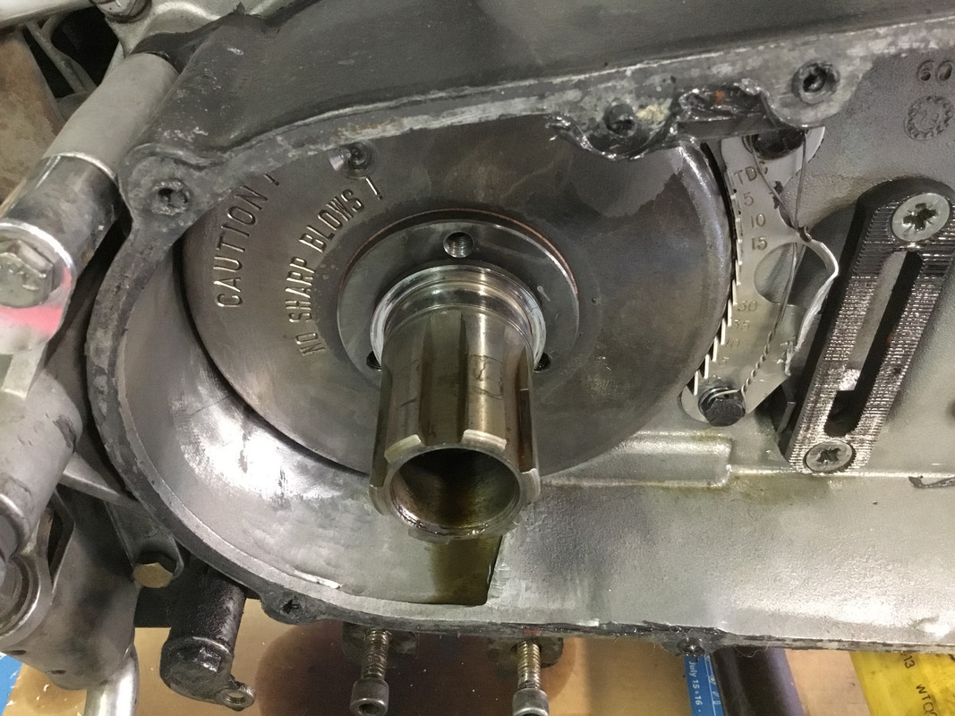

The adapter aginst the rotor, how do I get that off?

warm it up some with a propane torch, put on some gloves and grab it and pull it off, maybe whack it with a rubber mallet. it might have some residule red locktite holding it on, the warming is to melt the locktite.
